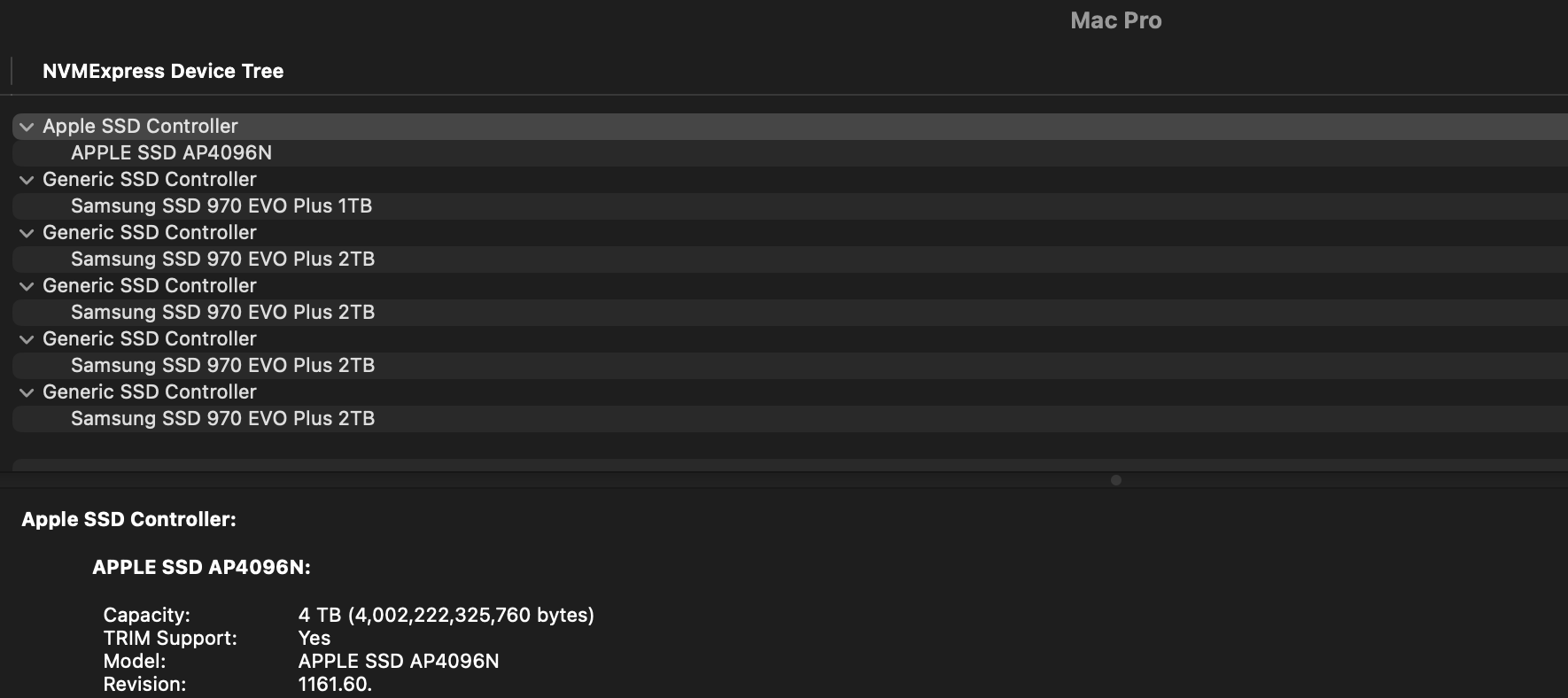

I had the notion that Apple's APFS took care of this function already?
Also checking my NVMe connected internal drives for both Apple and all the Samsung sticks, I see that TRIM Support is already indicated as "Yes".
What am I missing?
Nothing about APFS, NVMe has TRIM enabled in MacOS by default
Thanks for clarification. I meant APFS was created to handle NVMe drives and works better with TRIM and therefore would have been enabled by the OS from the get go without further manual enabling.
I am not sure about that.
But I believe APFS is designed for high performance solid state storage, not just NVMe.
And I think even with HFS+, macOS still enable TRIM for NVMe by default.
On the other hand, all other non NVMe SSD also work better with TRIM, but macOS default to disable TRIM for all of them.
I really don't know the logic behind, there is no consistence (except NVMe have everything).
