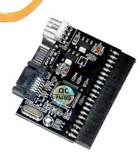

I wonder if there is a small sata > ide adapter available. I'm looking hard but can't find one.
Not small enough.
If you want larger, then you need to run an IDE cable out the back, or a SATA bridge/cable out the back.

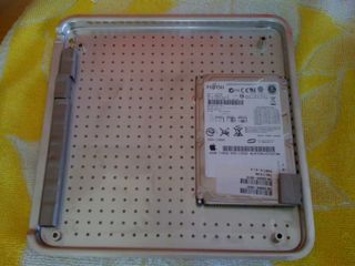

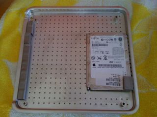

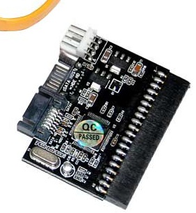

On ebay you can get Bidirectional IDE to SATA adaptors. The only problem is that the space in the AppleTV is limited.
