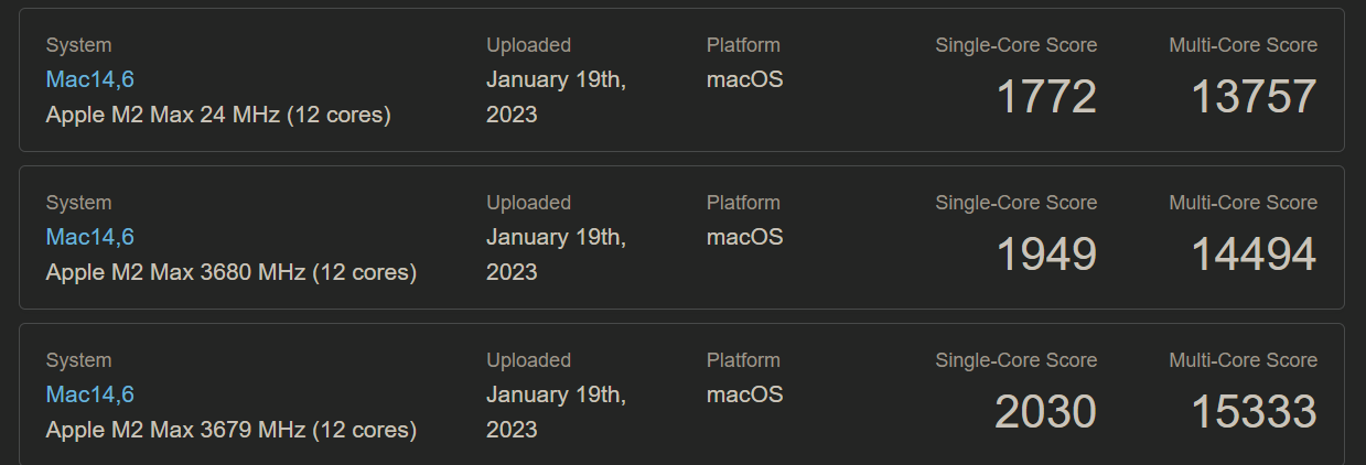

Yes, that is a concern, on geekbench I see the M2 max hovering between 13-15K points in multicore. And between 1772 and 2030 in single-core. I hope those are flukes because those are massive 10-20% variances that make it more like a 10-core M1 Pro! (1725 single core/12, 230 multi-core) I have to assume it is due to thermal throttling.

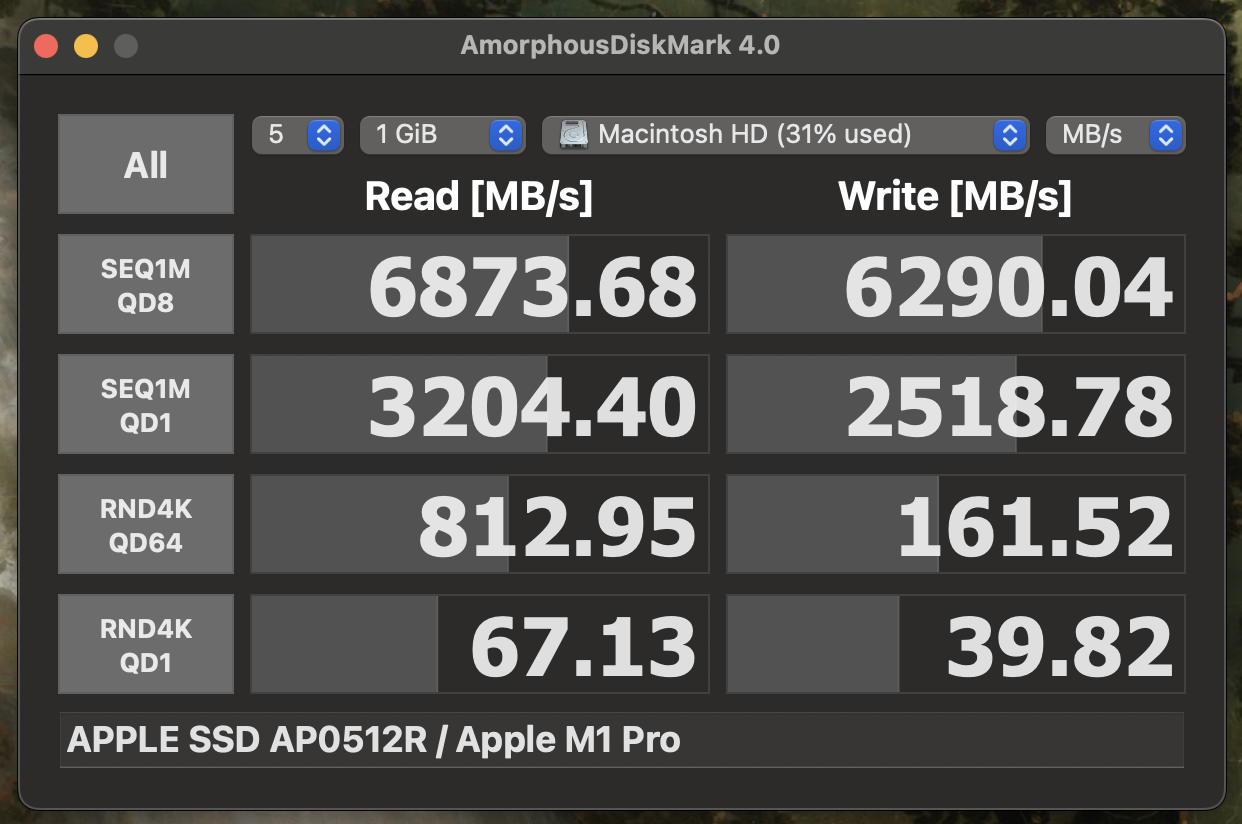

Would it be wiser to buy a M1 Pro 8core 16/500 or the M2 16/500? I’m a professional photog looking to upgrade our base editing station.
Considering the discount you will get, and the much faster drive, I would reccomend M1 pro compared to m2 pro. I cant fathom paying $2K/2.5K for a drive that is half the speed. Just mad.
