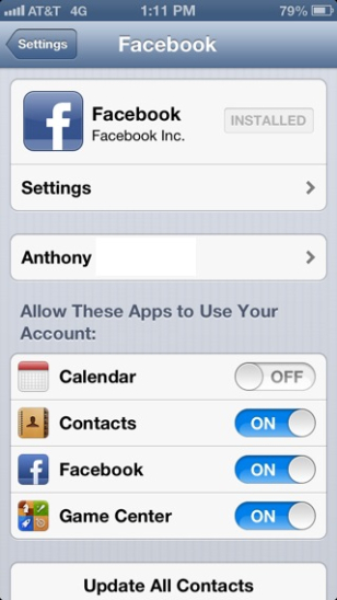

Settings > FaceBook > Allow these apps to use your: Calendars (off)
I created an account just to give you guys the solution.

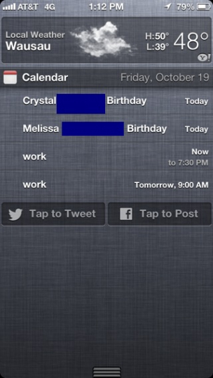

The issue is not facebook at all. It's just if you have ANY contacts that have the birthday field filled in. The trouble is that within notification center, you do not have the ability to specify which calendars will appear on your notification center, hopefully this is fixed with a software update soon!!
For contacts whose birthdays I need to track I add their birthdays manually to the iCloud version of the unified contact. This then shows up in the Notification Centre under Calendar. However, entries for birthdays for FB contacts started appearing in the Notification Centre as well. I had FB Calendar disabled and I only had the Birthday calendar for contacts available within Calendar. While for birthdays entered manually, events would show up inside the Calendar, for FB Contacts, they wouldn't yet they would still appear in the notification centre. And if you clicked on them from the notification centre, you would be taken to the Calendar app with the FB birthday calendar automatically activated.
What I did was follow someone's advice here to disable Contacts integration from FB's settings inside Settings > Facebook. I had to then load up the Calendar app to see the new settings. After that the FB calendar entries disappeared from the notification centre.

I am running iOS 6, when I logged into my account it began syncing all my friends birthdays to my calendar. This is not a big deal, as i can simply hide that calendar so they will not show up. However hiding the calendar will not remove the birthdays from the notification center. Having them there is very annoying and I would love to find out how to remove, only the events that came with Facebook, from notification center. Any help would be great!
Settings > Facebook > Allow These Apps to Use Your Account section > Turn 'Contacts' and 'Calendar' OFF. Leave Facebook ON.
