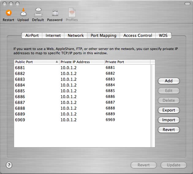

This might be what you're looking for, from the Airport Admin Utility:
Oh okay cool thanks for that. Okay so i opened port 6881 in airport admin utility which is the incoming TCP listen port in azureus. Is it set now.

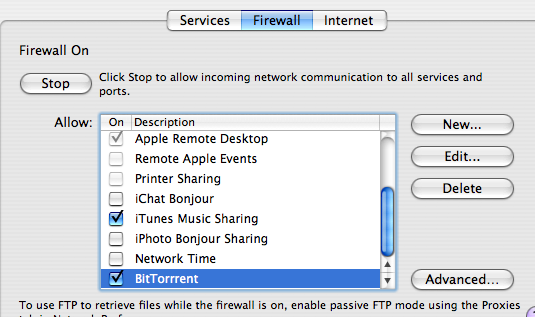

You might also want to open ports in OSX firewall for BT.
Add a new port name and fill in the ranges.
Cool thanks for that tip. However i don't use firewall's.
Does it matter what the Private IP address is in the Admin Utility? Yours say 10.0.1.2, but mine say something different, but very close.
Daniel
Daniel
That's the internal IP on my house wifi network, the actual IP to the real world is different, as crazzyeddie said you'll need to make sure it matches (it usually does).
