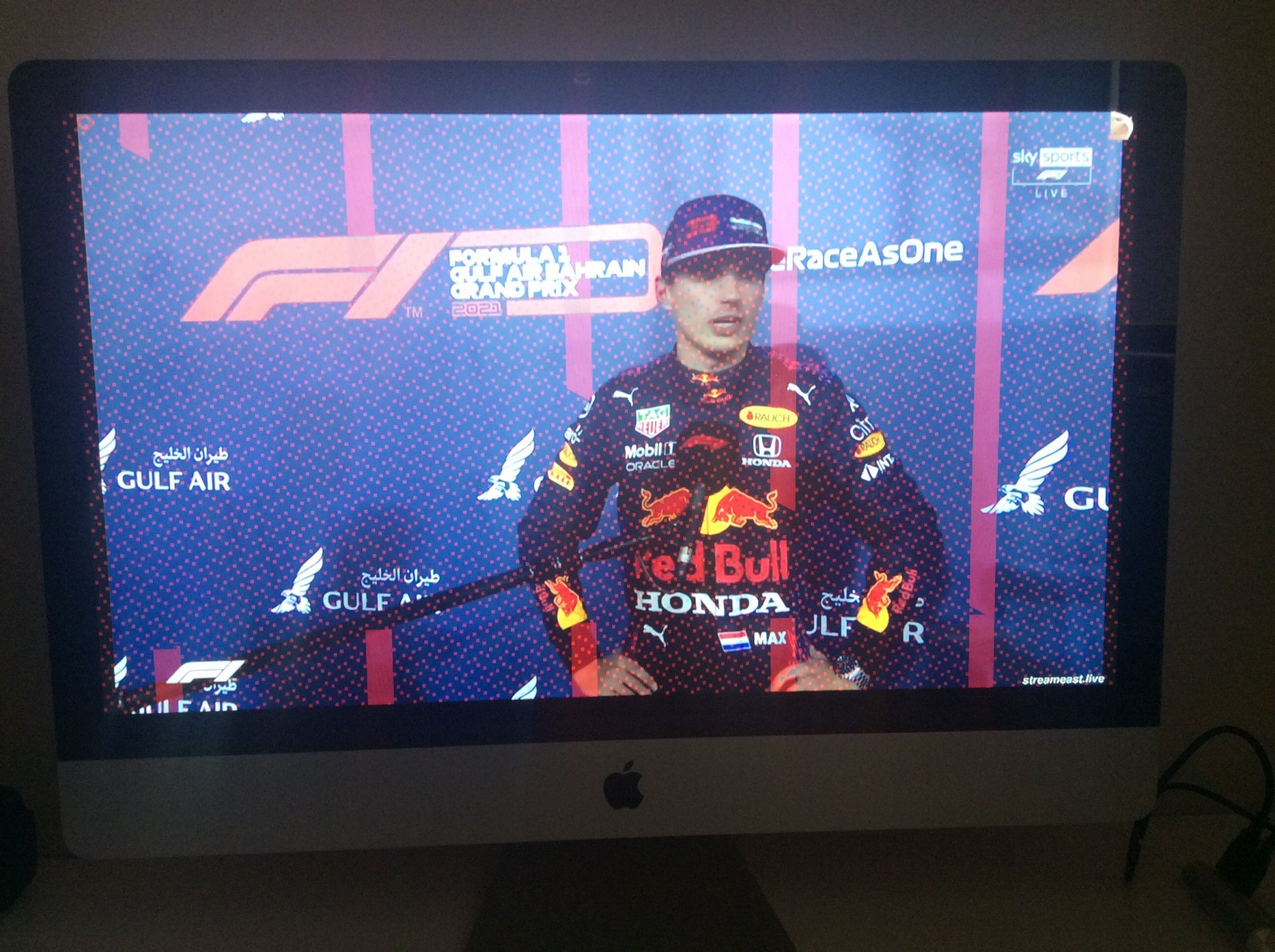

Hello, I have an iMac late-2009 with Core i5 @ 2.66 GHz, 8 GB of RAM, 1 TB HDD, 512 GB SSD and ATI Radeon 4850.

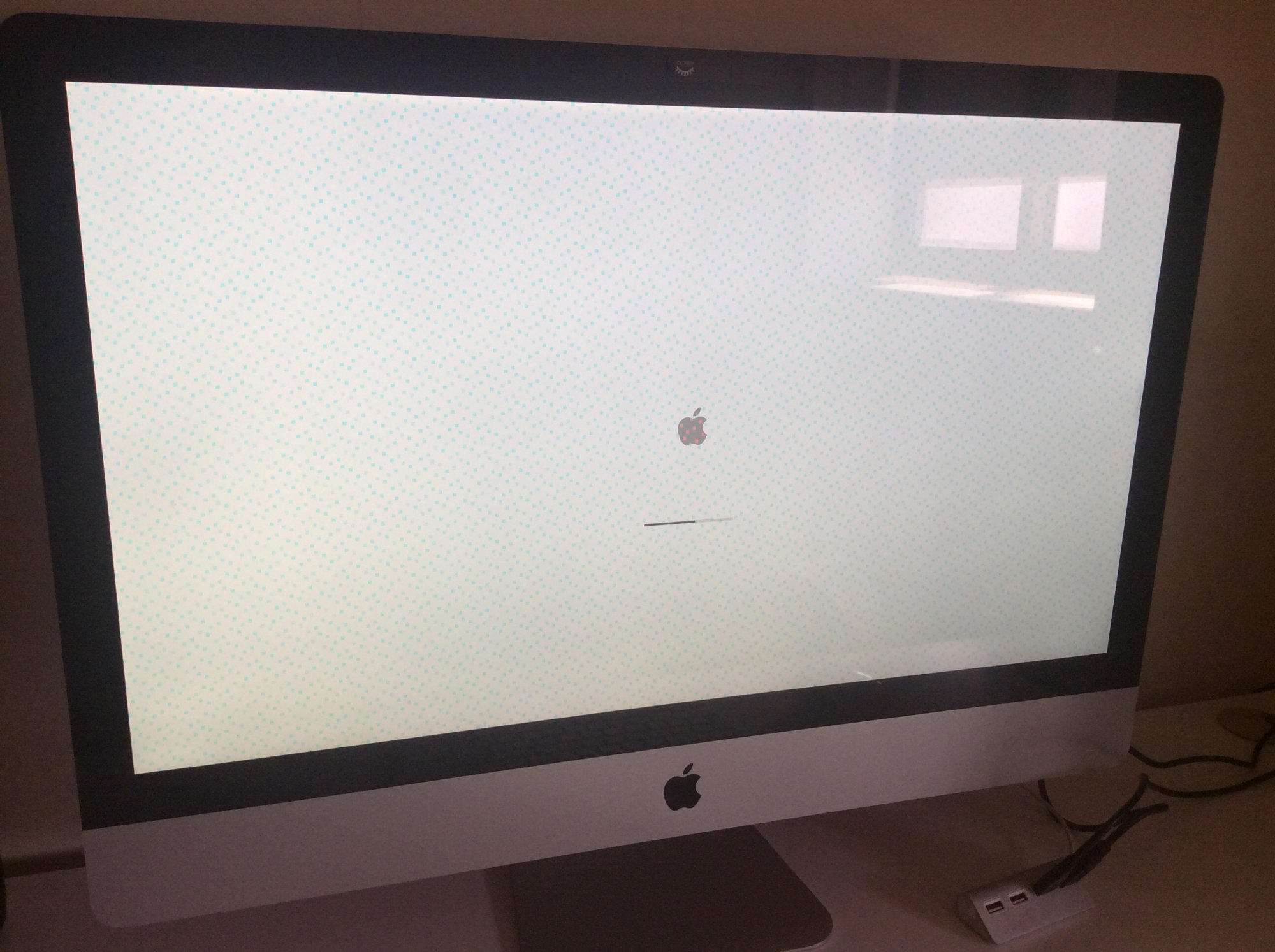

One day I left my iMac active and alone for a few hours. Then I went back and found out that the system restarted itself (I don't know why) and was stuck in the Apple logo screen with the loading bar frozen halfway, with weird cyan squares and pink vertical bars.
I had to turn off the Mac manually, turned on but then the same thing happened again. Mac stuck in the Apple logo screen and the loading bar frozen halfway.
I repeated this about ten times -- I even tried to boot up from a couple of external drives with Time Machine backups, with no success. Suddenly, at the 11th try the desktop appeared normally.

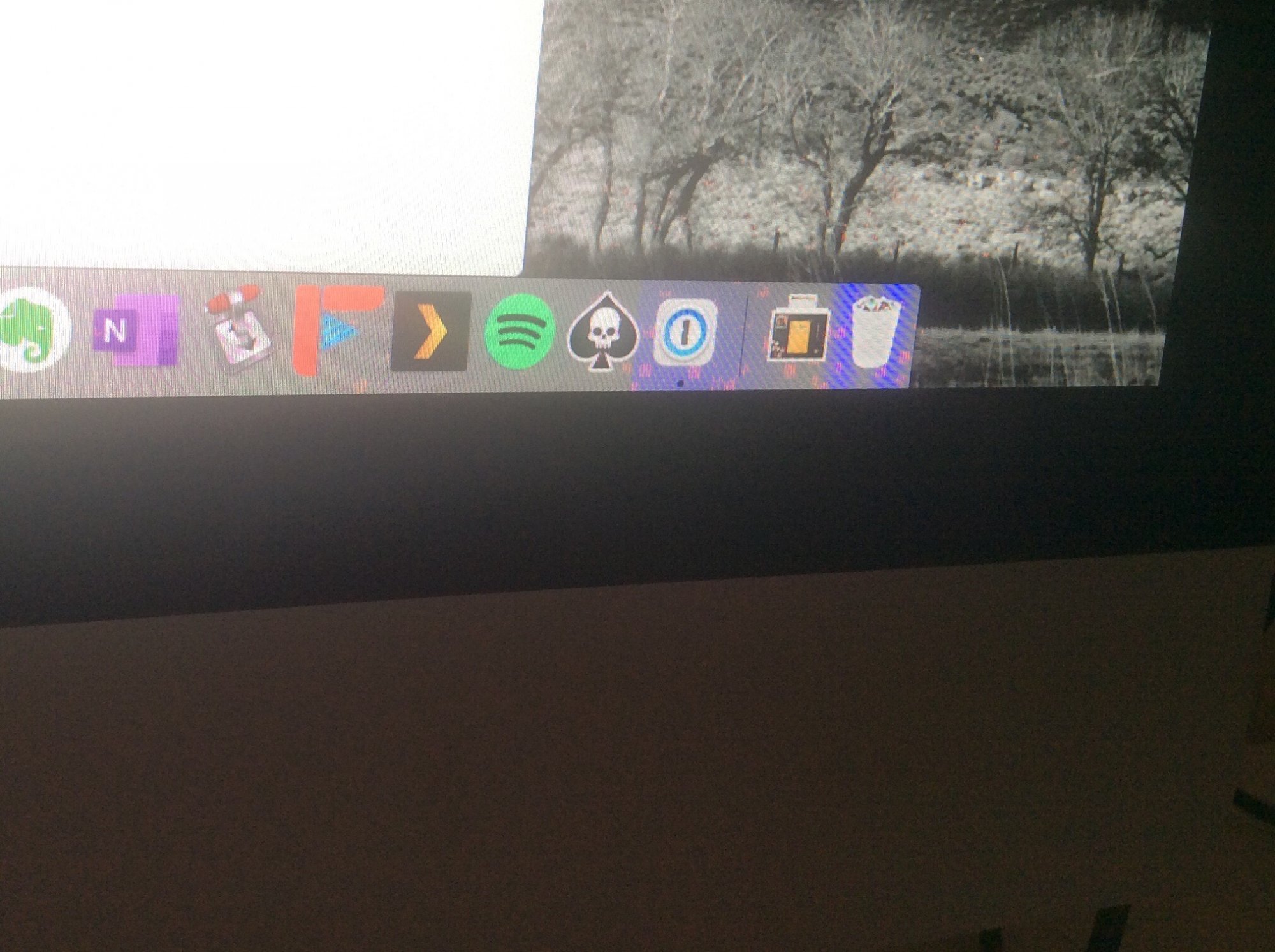

However, after a while those weird pixels started appearing in certaing areas of the screen again.
Finally I tried to play a video in VLC. Everything was kind of fine until the screen got stuck again, however this time it was the image and the AUDIO too that got stuck.
Nowadays I just can't access the desktop, since the display steel freezes in the boot screen with those weird pixels, pink bars and the loading bar stuck in the middle. However, it seems like the system do reach the login screen, since despite the aforementioned, I can hear the sound of a couple of notifications that can only be heard in the login screen.

It is most likely the GPU on the video card. Most often the symptoms are the black screen of demise, but sometimes you get what you see. There are some videos on Youtube of people baking the video card and then having it work for a while longer (it's a crapshoot on how long). You could also try replacing the thermal compound on the GPU to see if that makes a difference.

Your GPU has failed.
I got the same machine, same GPU, same symptom.
I took out the GPU, send it to a laptop repair shop to rebake it on professional reflow station. Couldn't fix it that way.
I bought another MXM card and my iMac was working again.
