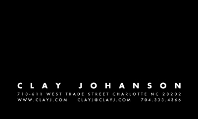

Janey, try http://www.globalprintrunner.com/. I got my cards done there a few years ago and they're great. Something like $60 for 1000 cards, 4 color front, black text on the back. I did the front in black with white text, and the back in white on black text, the exact opposite of the front.

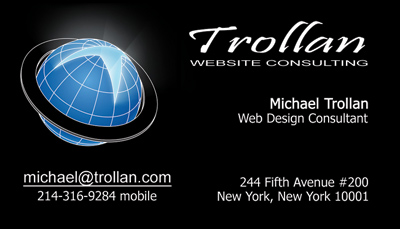

I just picked up my first stack of black business cards, printed at Kinko's. I printed them on gloss front/matte back, full color. They came out great, and the white edge doesn't detract from the card at all. It's not even perceptible when you're holding one card.

Here's a snap of my latest cards from these guys:

It's not black card stock, it's just a illustrator file with a black background with white text. There are templates you can download at the site - use those so you get the right dimensions and cut off margins.

i got my black business cards printed long long ago (like 2007 ago), here's a (sucky) pic, it was exactly what blue velvet suggested on matte white stock, and a little spot gloss:
got them printed by print100.com, decent pricing and fast delivery.
since then i've gotten two more - one is just standard white, and my newest personal one is a silvery gray. i hate white, but it turns out you can't write anything on black and have it show up easily. i totally forgot about that when i did the black business cards, but on the other side was a stripe of non-black that people would scribble on if they needed to...not sure I'd go that route again. Maybe all black on one side, but a different color on the other.
