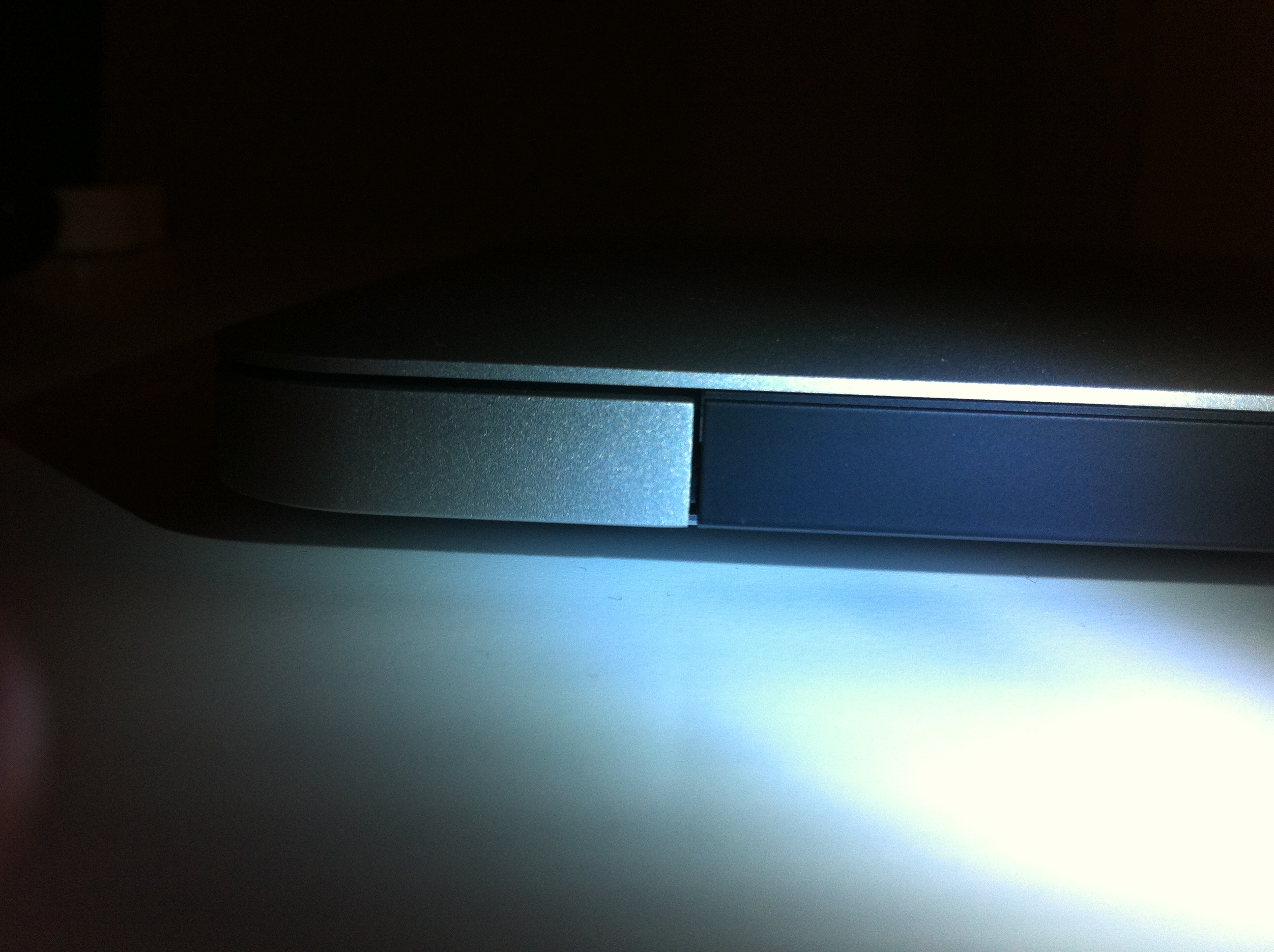

My dad just got his first MBA yesterday and noticed that the black hinge (seen from the back when lid closed) is slightly uneven. We compared it to mine, which also had it. Is it normal or should we be worried? It is only in the left side there is a gap. The right side is all right and align.

You don't notice a small (very small, you might have to zoom) gap between the black hinge and the silver-body? It just seems slightly off-centered

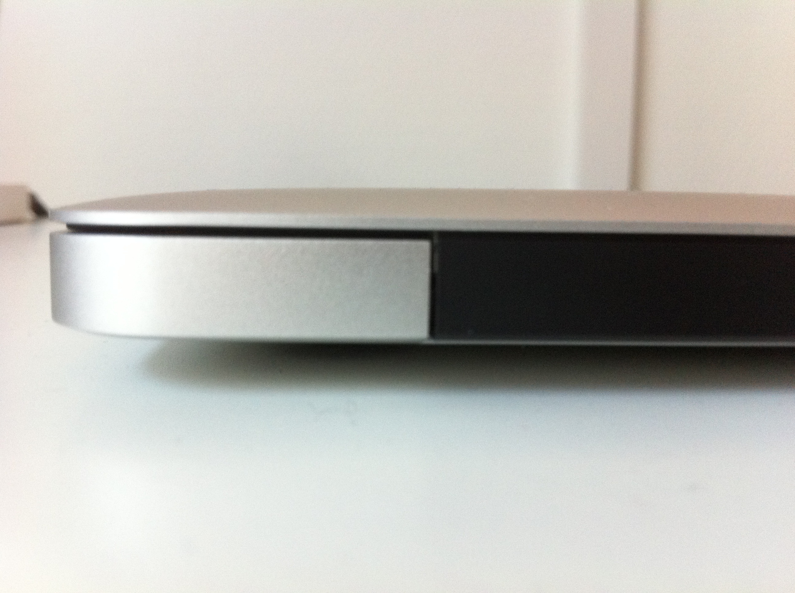

Okay, it's actually pretty hard to take a picture, but what about this one - more clear?
I know I might be OCD'ing, but just wanted to know if its normal 🙂
Zoomed it. Still can't see.
Even if so, that's not a critical area. The black thing is just the cover, what matters is what goes on underneath. If it feels smooth (like mine 😀) then is doing its job and stop obsessing.

The cluch cover can slide (that's how you remove it) - so you should actually be able to slide it into the middle if it bothers you 😛
It looks fine to me! If it works properly and doesn't make any noise when you open/close it, don't worry. 🙂
Haven't tried sliding it, but that would explain the off-centered!
The lid is aligned with the body so no unevenness, and no cracking/noisy sounds when opening/closing lid.
Thanks for clearing it up guys! Good to know it's normal and that you've all seen it before 😀
