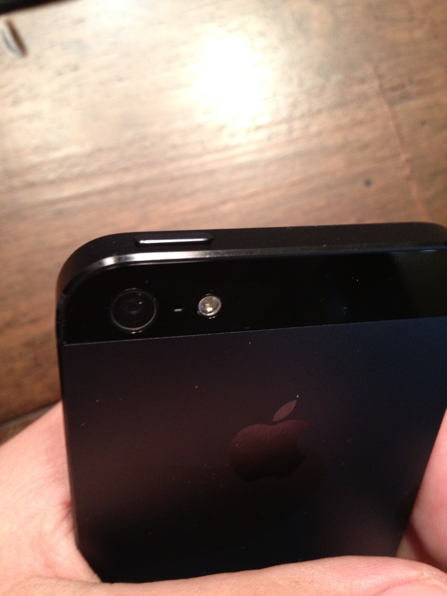

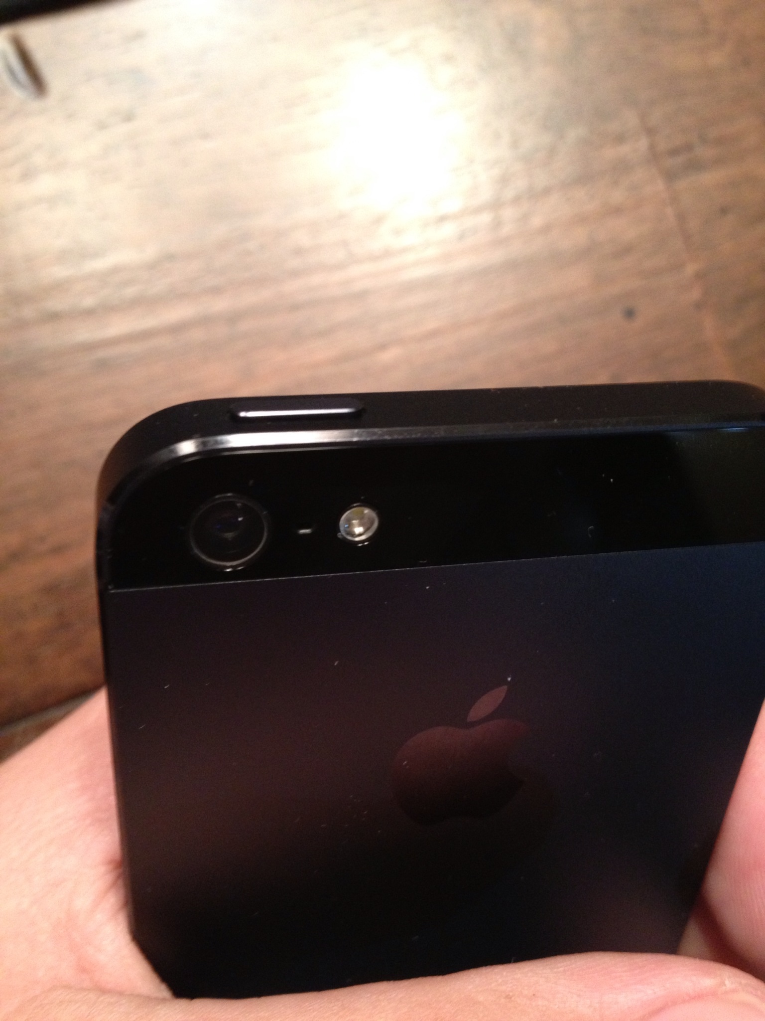

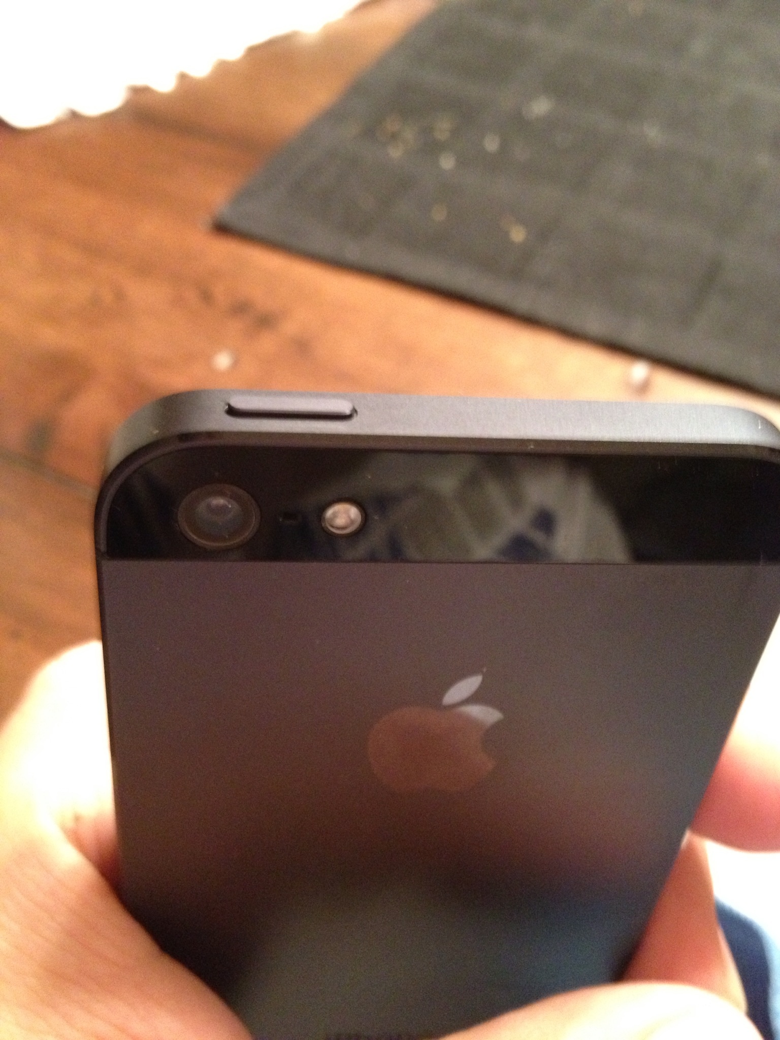

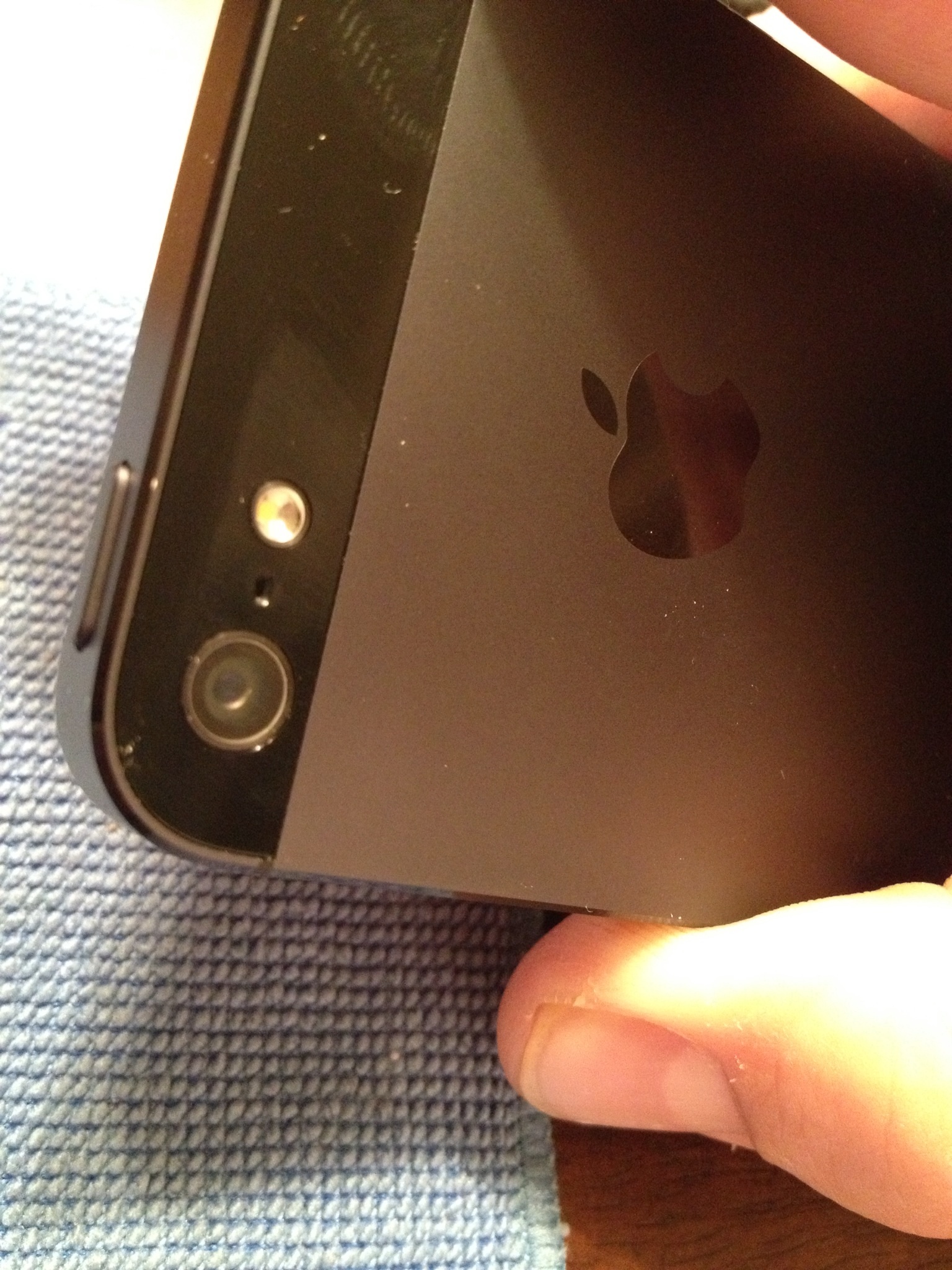

My birchwood touch up pen in glossy black came in so I gave it a shot. I wanted to do it on the smallest of the 3 scuffs that came on my phone so sorry if its hard to see.
Step 1: put some alcohol on a paper towel and wiped the scuff good to get it clean.
Step 2: shook up pen and dabbed some paint on a paper plate.
Step 3: dipped plastic toothpick in paint and lightly dabbed it on the phone.
Step 4: checked scuff and there was still a lighter area showing threw.
Step 5: put more paint on plate and applied some more to the phone with the toothpick
That was it. It was easy and came out looking great. Tomorrow I will put my incipio frequency case on and take it off to see how it holds up. Below are some pics. The scuff is right below the power button. I really can't see anything on there now so I think it worked really well. I will update on weather or not it sticks. I wouldn't try the glossy on the flat areas but it seems to match the chamfered edge really well. I'm not doing the other 2 scuffs yet because I'm still thinking about exchanging it.
Here is the scuff right below the power button. Yes it's very small.
With light shining directly on it you can see a slightly lighter color but you really have to look for it.

I am happy to report that the birchwood paint is sticking really well to the phone. I have taken my incipio case on and off a couple times and paint has not rubbed off. I think I am just going to repair the other 2 spots and keep my iPhone instead of trying for a second replacement.

I got the eBay knock off of the Poetic atmosphere case and after struggling to get it off it seems to have taken the Birchwood paint off the phone. I think it would work ok on a naked phone but it seems like some cases may take it off. It was still fine after using a switch easy tones case and the Incipio frequency case. Luckily I went to the store this weekend and was able to get a replacement that is pretty much perfect. Hopefully I won’t have to use the pen again until time to sell.
