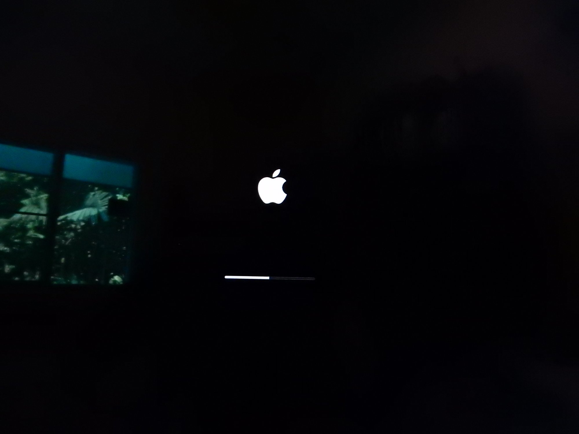

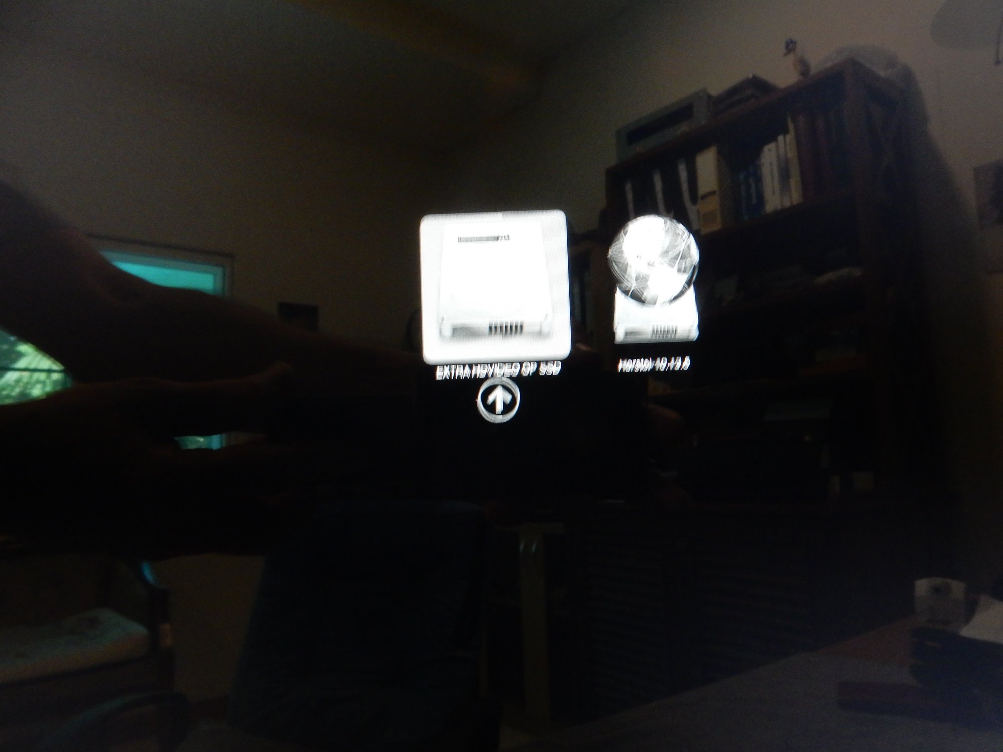

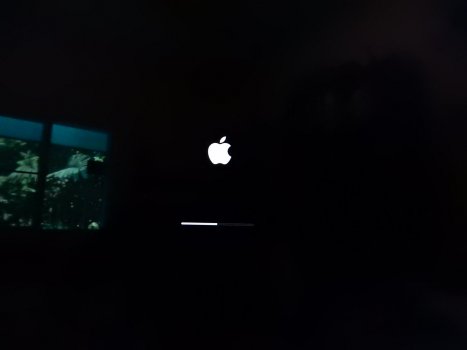

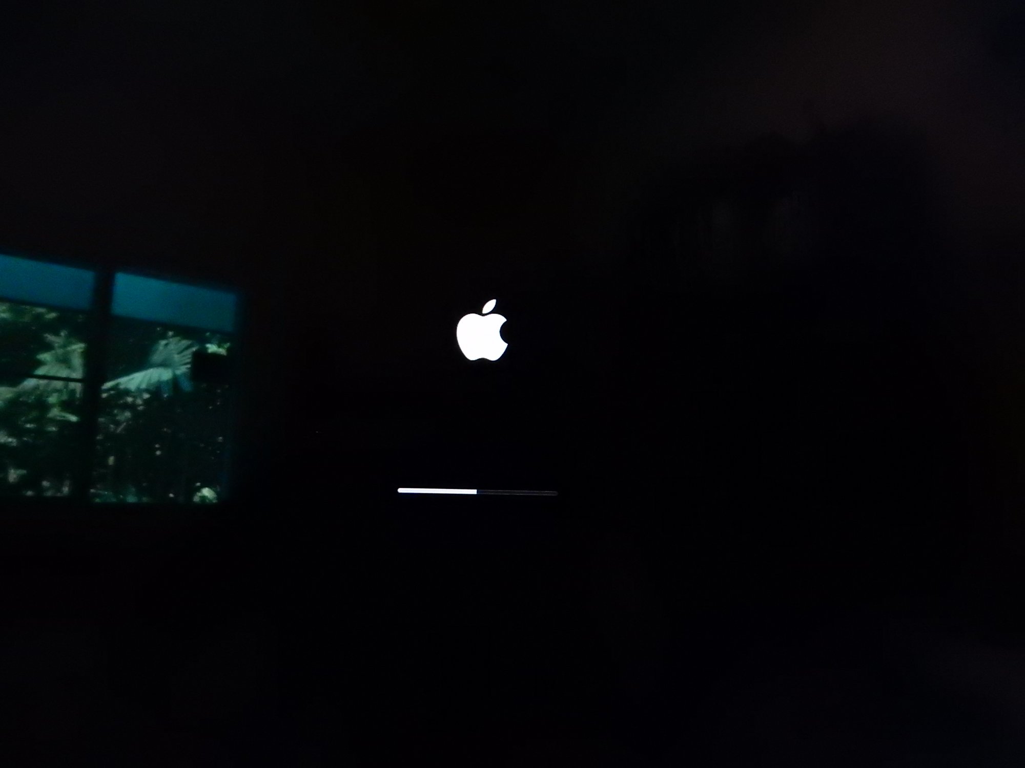

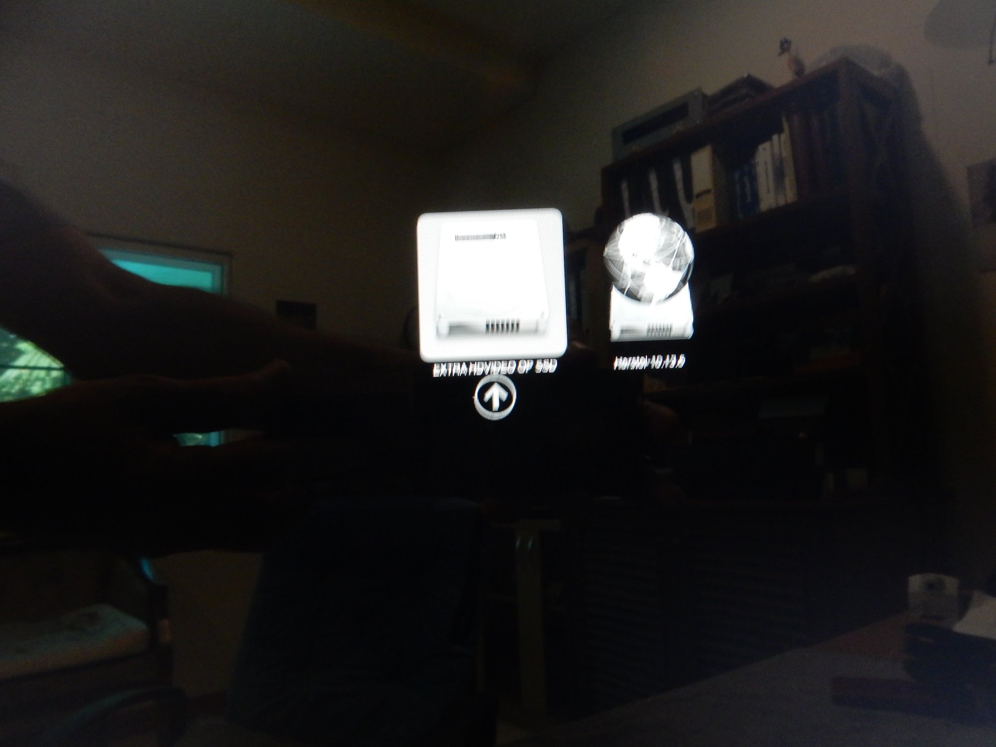

When start up, start-up screen shows up, I can make choice for ssd, or recovery, after apple logo and progrss bar shows up for half away.
