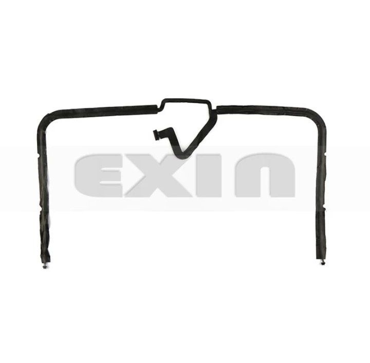

what do you think about this
You CAN find separate cables on eBay - https://www.ebay.com/itm/254956894050
That link appears to be the video data cable. Did not find the other cable (display power), but I didn't take a lot of time... Maybe you can also search for it. (the data cable might be a fix, if it is used for the backlight control, IDK)

that ebay link you sent is the energy flex
suppose that this is the flex that I need, this is the one that goes to the MotherBoard
I would like to see more information about it because this may be the flex that sends the energy so that the screen lights up
