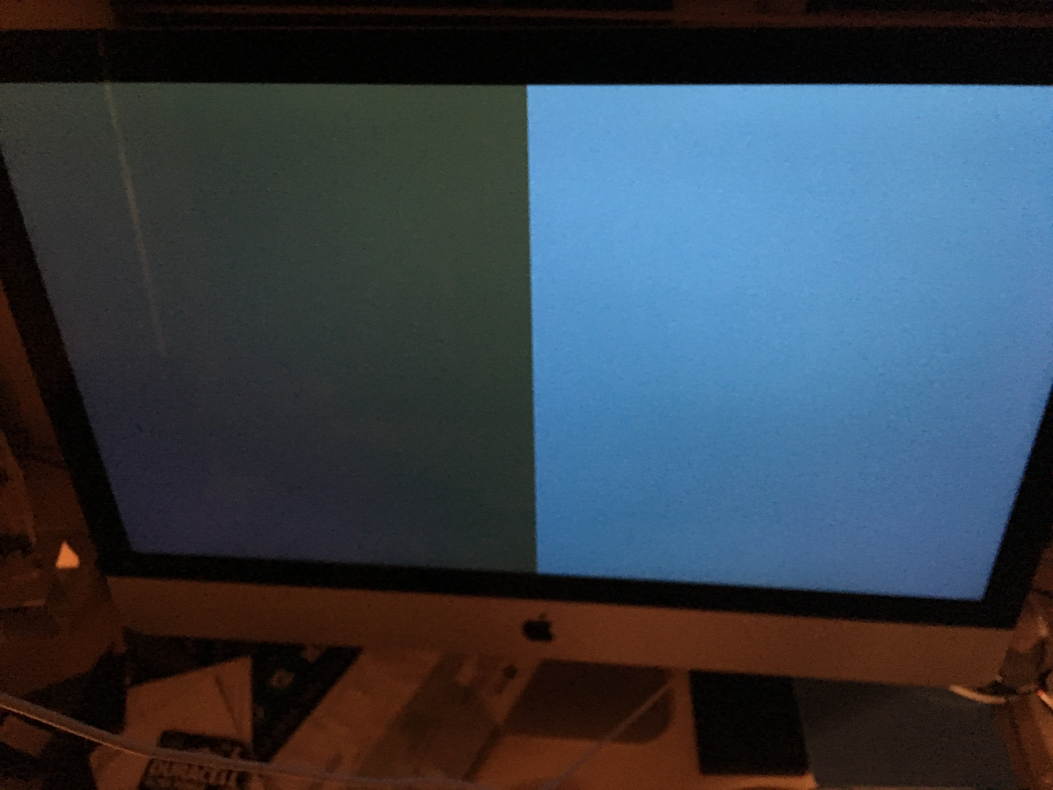

I have a late 2009 27" iMac with blue vertical lines. I opened it and tried to bake the video card and put it back in but I got a blank screen with the backlight on. I connected my iMac to TV to see if the video card is toast but it showed up okay on my TV screen. I bought a display port cable thinking I broke it and installed it, but it's still showing black screen. Anyone has any idea or suggestion what I should do? Maybe I broke the vertical sync cable?
I ordered a used one from powerbookmedic.com but it still won't work. I wonder if it's a bad cable or I broke another cable?

How about the connector to the motherboard? its a known weak point, if you pulled the screen too far out before removing the cable you may have seperated some of the connections.
Also the video card may be an issue. 2008-2011 imacs graphics cards start failing pretty regularly.
