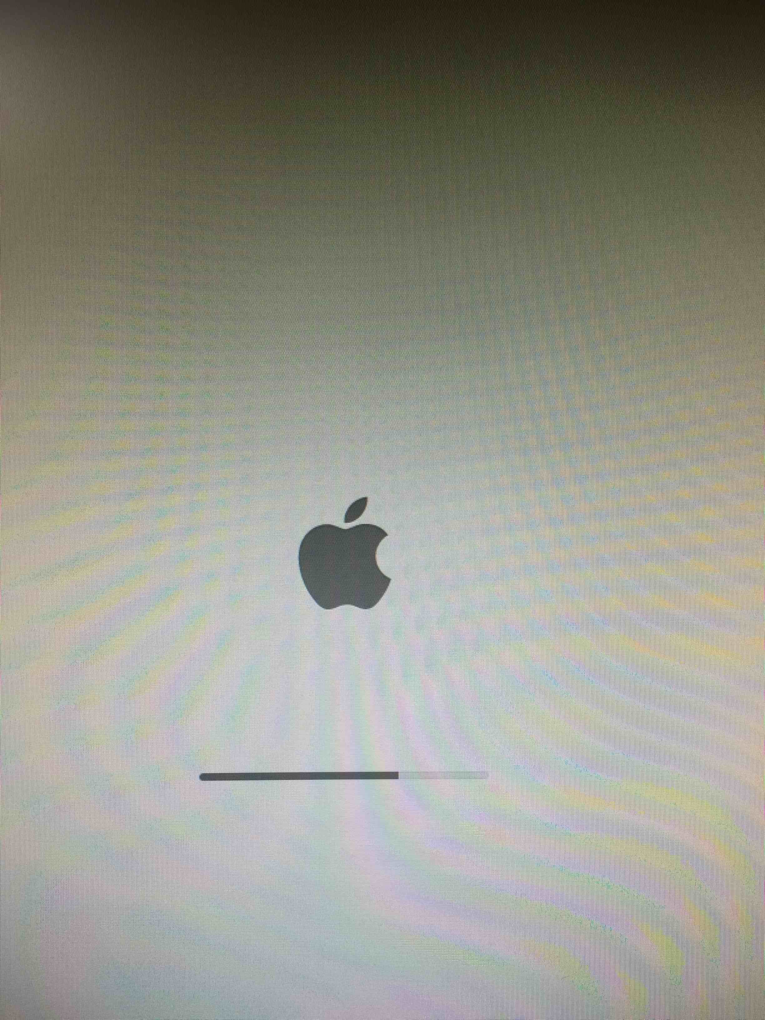

whit the original Ati5770 it's stop at this screen...
and now? What i do?

do a verbose boot. restart holding Command-V. There will be text. reading that text may give more information about what task is causing the delay. Without more information, everyone is just guessing. In verbose boot , Disk I/O errors would indicate failing storage device.
After an improper shut down , the next boot will always take longer. I'd wait at least 5 minutes before declaring a stuck boot up. Sometimes the boot will hang due to failing FSCK too, it will attempt 3 times to repair and then shut down. In a verbose start up , you can read the progress.
note: after a verbose start up , the next shut down will also be verbose. This isn't a problem and is expected.
