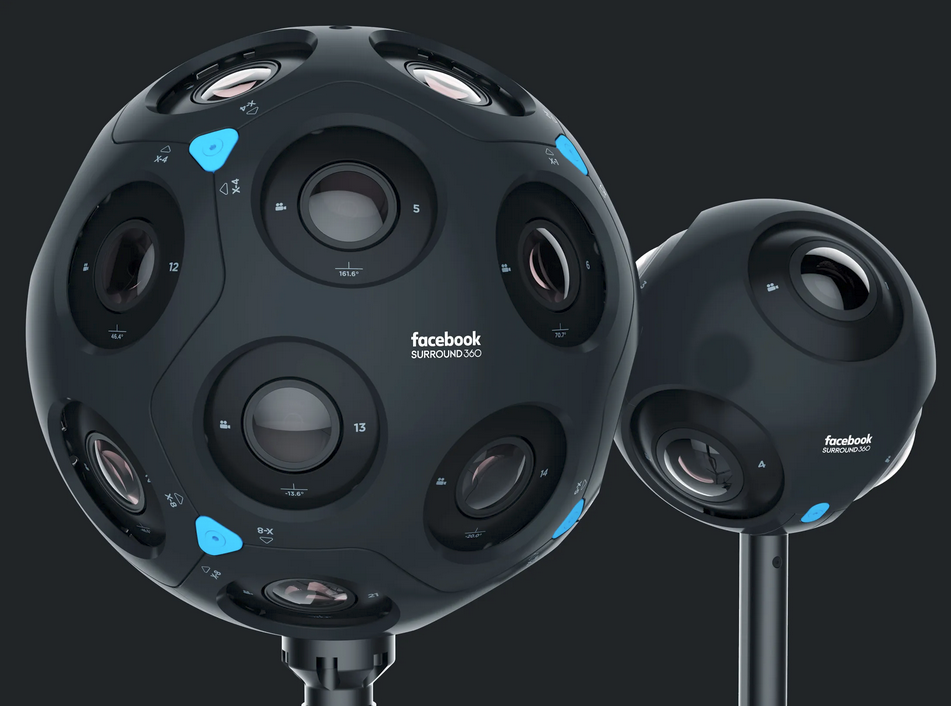

If you want actual look-around VR content you need to capture a few more angles... like that device here from 2017:

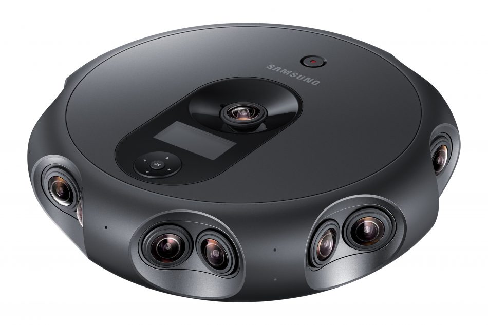

or https://www.insta360.com/product/insta360-pro
Or for more than just horizontal capture looks like that:
