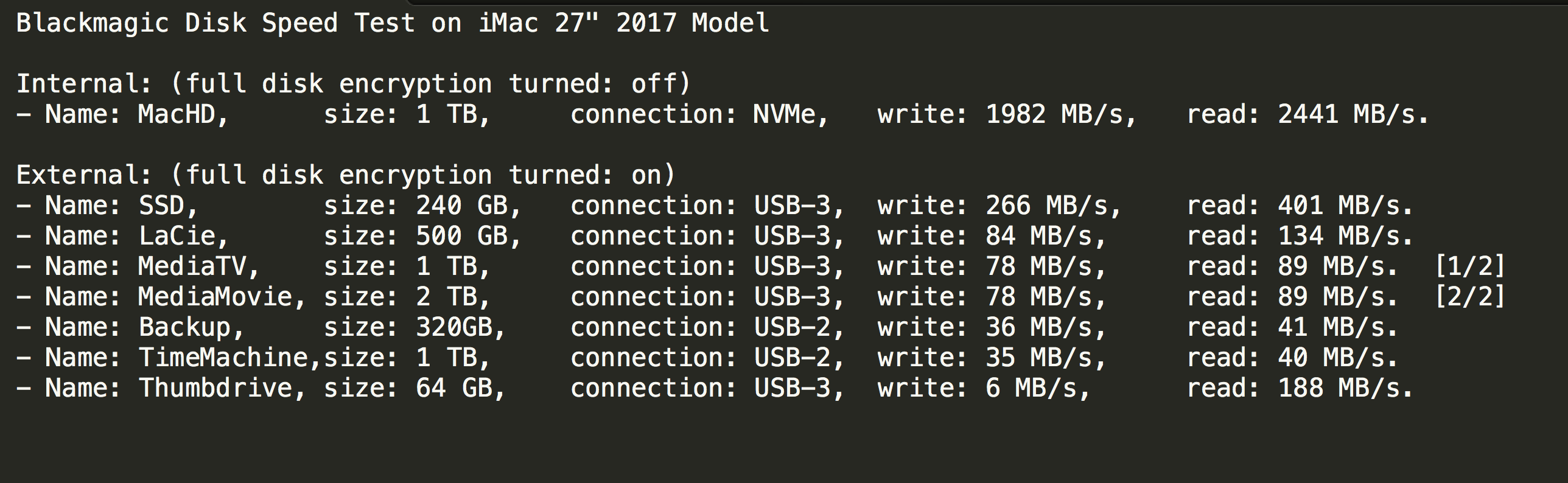

These are my speeds of my old 7200rpm HDD external disks on usb3 and usb2 cables into the new iMac on usb3.
Since I took this test, and wrote the data down. I got a usbc->sata3 adapter cable for the usb-c port and the SSD went from 265 write & 400 read to 266 write & 500 read (maxing out the disk).
It depends on what the max is for that drive, which connection it's actually on, on both sides, and what speeds the cables, connections, etc are, and what the hardware can support at all.
