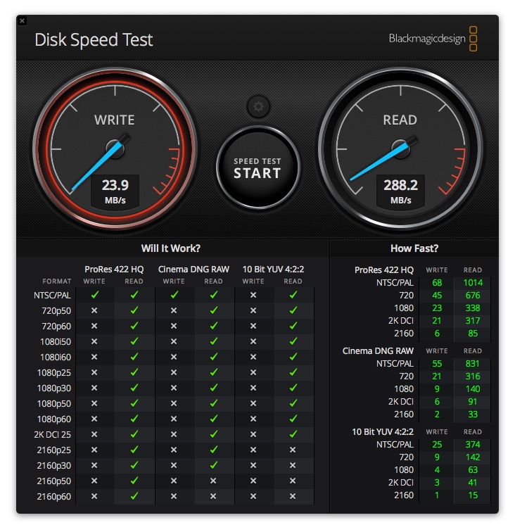

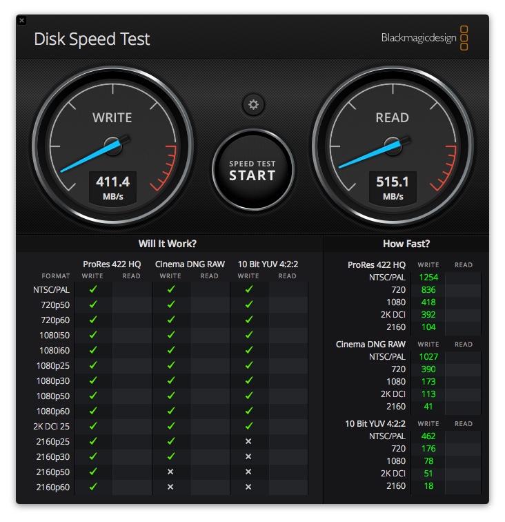

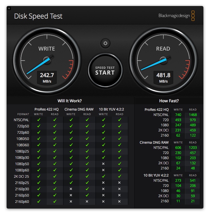

My experience is different:
I recently got a MBP from 2012 with a Samsung 840 Pro 512GB, where TRIM was not yet enabled. The read, but particularly the write speeds were abysmal:
I turned on TRIM and within a few minutes the readouts dramatically bettered - for both write and read:
Fast forward 30min, the practically to be expected factory values were restored
So, TRIM is clearly useful (it depends on the SSD type, not all brands/types react so positively to it).

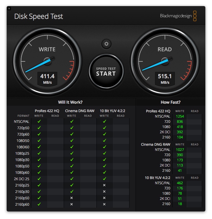

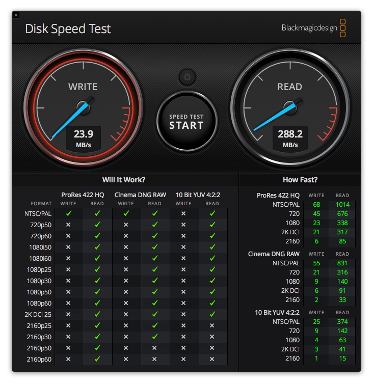

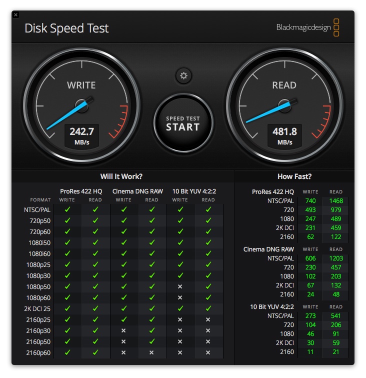

Best,
Magnus
The 840 Pro is an older SSD (introduced in Fall, 2012). Something extreme is going on with the drive as 24 MB/sec write is the performance one would expect from a HDD going bad. You can also see that whatever is going on affects the write performance much more than the read. For the OP the degradation affected write and read more equally.
But based on what you've presented, in the future I would say that for current name-brand SSD's, TRIM is unlikely to affect read speeds and is unlikely to be the problem if you experience consistent degradation between write and read. If someone comes up with a current name-brand SSD that exhibits the same behavior, I can be convinced otherwise (but please don't use a DRAM-less or a QLC SSD).
