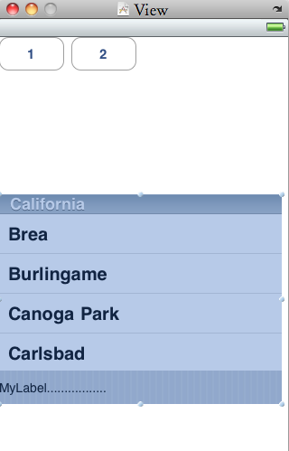

In the attached screenshot you can see that I have the UITableView selected. The area of the UITableView that is always blank is the lower 20 pixels, so I put a label on top of that area in order to make use of that area.
When I do command-R in IB, the UITableView works fine. It's only when it's used in the context of the larger navigation app that there's a blank area.

Remove the label and attach a new screenshot, along with the Size Inspector settings as well.

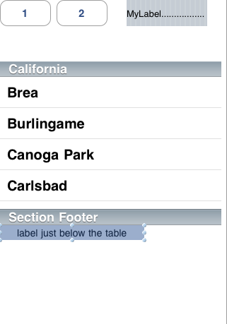

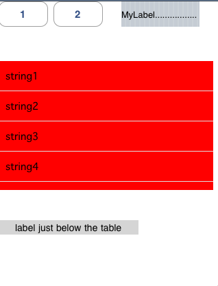

OK, here's what I've done. I moved the table up and put a label just below it. The background of the label is gray. Running it in IB it's clear that these are adjacent. In the code, I set the background of the table to red so that it's clear where it is. But this also shows the basic problem: When run, the table shortens by about 20 pixels, so now there is the blank area between the red table and gray label, which is the subject of this thread. Thus it appears that something is causing the table to shorten at runtime.

What are the autoresize settings for your table view? (Which is why I asked earlier for a screenshot of your Settings Inspector as well.)
Wow... That was it. I disabled "autoresize subviews" in the view and now the table is the size that I specified in IB.
