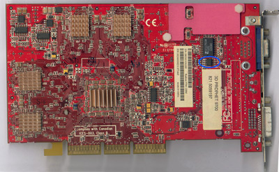

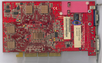

If you don't have a PC, check what EEPROM size this card has before flashing it on a Mac. If you'll be trying to flash 128K ROM on card with 64K EEPROM, you'll end with bricked card which will be unrecoverable on a Mac, only in PC.
On 9700 reference board EEPROM is located here:
OK, the 9800SE rom on Macelite page is 64k so it should not be a problem? There is also reduced rom available for 9800 Non Pro which is 64k, maybe I could try that also?
SE and Pro ROMs are in both sizes. It's always better to use full 128K ROM, you just need to be sure that it will fit on the chip you want to flash. If you're doin' it on a PC there's no big deal if you'll get programming error in the middle of flashing process. On a Mac it's not so simple after that.
