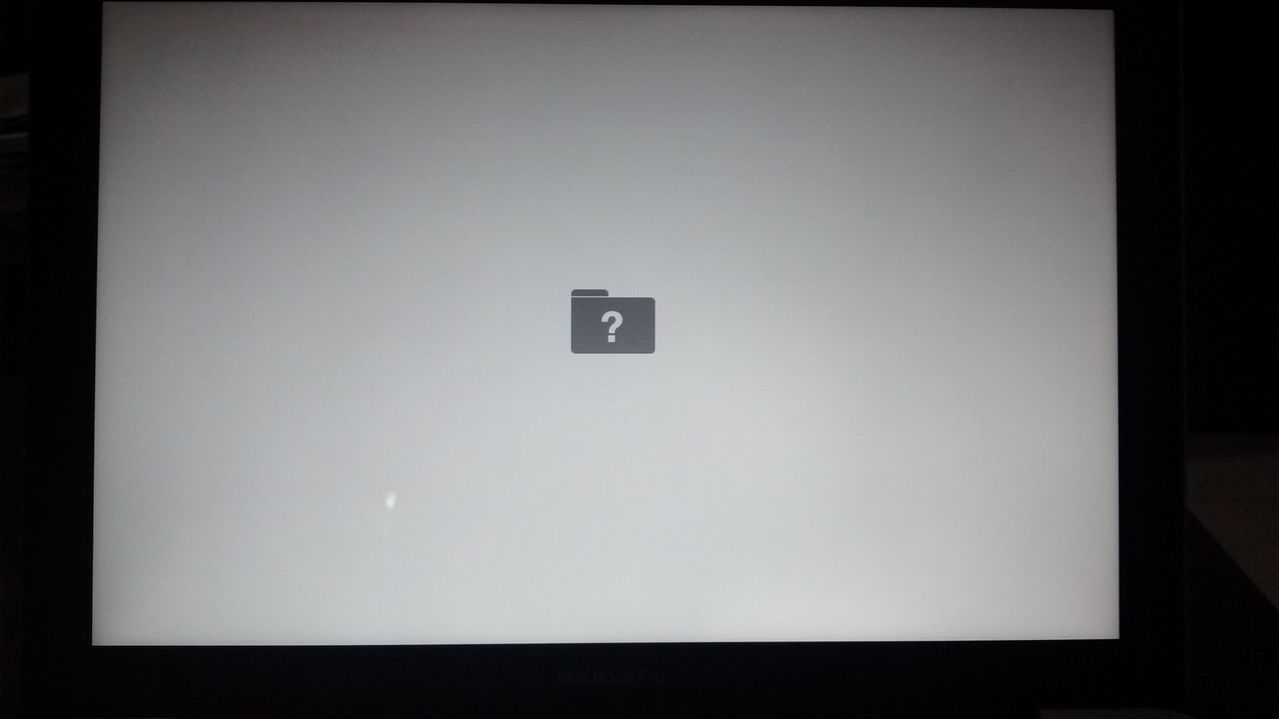

I have a MacBook Pro mid 2012, and I have installed Yosemite Beta when it was released. It was working fine till yesterday when suddenly the system hung up. After a restart it crashed again and during next restart it showed that the error was with launchd process failing or something like that. When I restart it again, it doesn't show the Apple logo, but it now shows the blinking folder icon with a question mark, like this.

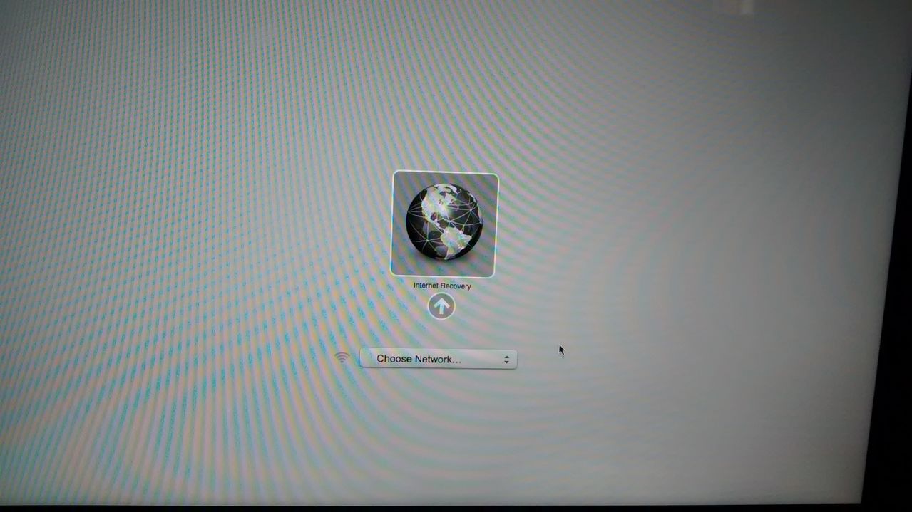

If I try booting with alt key, this is what it shows:

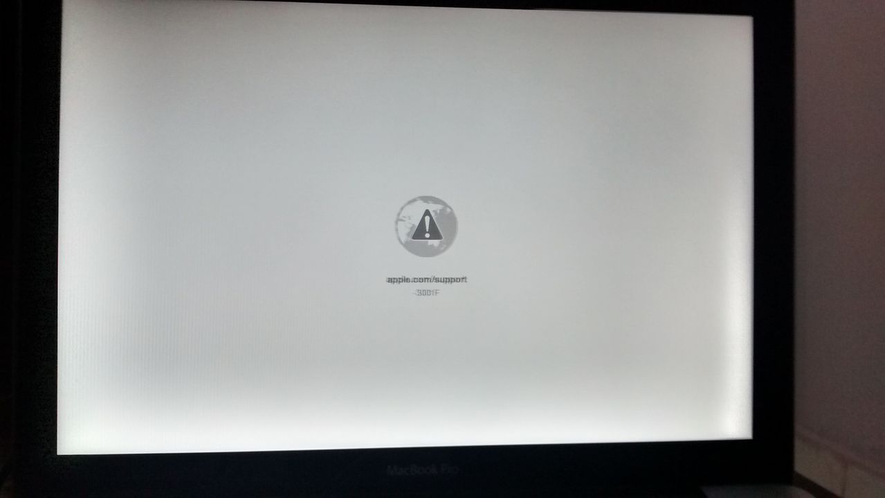

Tried a NVRAM/PRAM reset, and didn't work. When I connect to a network and try Internet recovery (which I am not sure whether I should do or not if I want my files back), it shows this:

Not gonna lie, the fact that the drive didn't show up when Ubuntu was loaded is troubling.
But I'd still try target disk mode next.
http://support.apple.com/kb/PH10725
It will require you to find a friend with a Mac and use a firewire or Thunderbolt cable between the two Macs. I wish I knew of a way to do something with your windows machine but target disk mode from Mac to Mac is the most surefire way I know to power through big problems. It'll be worth the hassle.
(A genius bar appointment can also do the trick if you know of no other Macs near you.)
The 2nd thing I'd try is to make a bootable OS X USB drive and load it on your computer:
http://www.macworld.com/article/236...otable-os-x-10-10-yosemite-install-drive.html
(May need the friend's Mac to make that too.)
This is basically a real-world recreation of your recovery drive that won't load. Once that's loaded run Disk Utility from the USB drive and see if it can repair anything.
But target disk mode is safer. I'd really want to try copying stuff off that way before I tried any kind of repair.
