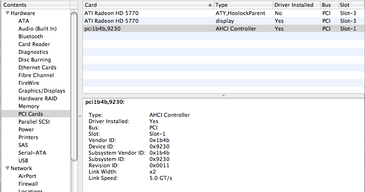

It also shows up in Target Disk Mode as Unknown Device, and shows up in System Profiler/System Information. Below you can see it highlighted:
So what do we do from here?
It's not "dead" and something may just have went wrong with it's driver or the copy of OS X on it's system files, and it's not being seen as a storage/boot drive anymore, instead only an AHCI controller. I don't know what this means precisely but it has something to do with the card that powers the 2 SSD blades in the RAID 0 card. Does this mean it's only picking up the main card controller and the blades aren't being sensed?
This following link says that the AHCI Controller in the type field is actually normal, and that may mean even further proof the card is not dead.
https://www.lifewire.com/owc-mercury-accelsior-e2-review-2260420
