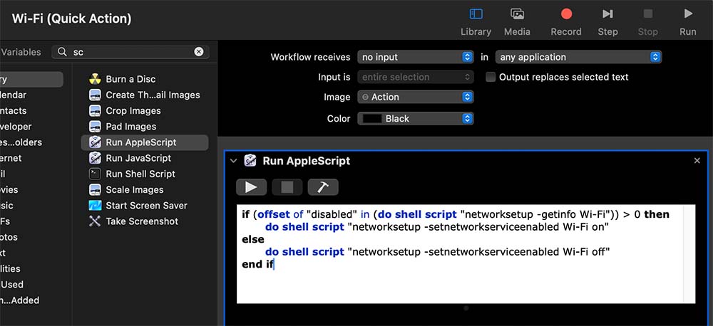

It works as an application, but would it be possible to add it as a service in SystemSettings-Keyboard shortcuts-Services as I did with the older Wifi workflow I made long time ago in Sonoma? I even assigned a function key and it still works.
Now the same process for the network doesn’t work in Sequoia
I tried to add it- as a workflow-in the folder Services, in my User/Library/Services giving it full access but it doesn’t work or even appear in the Services settings, where I would like to assign another function.key
Of course I restarted but still ...
Am I missing something?
In Sequoia 15.7.4

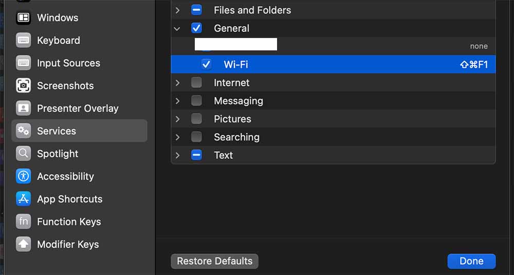

Automator – New – Quick Action – Workflow receives no input – in any application – Run AppleScript - Save as Wi-Fi
then System Settings- Keyboard – Keyboard Shortcuts – Services – General – I set the shortcut for Wi-Fi to Command+Shift+F1 (⌘⇧F1)
