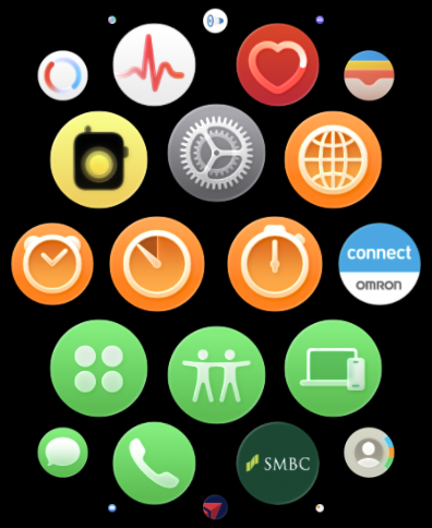

its on my Watch.
for over 3 years. using Series 8.
as per below screen shot.
screen shot taken directly on my apple Watch.
hope you work out your difficulties with it.
but I'm not in the USA so that may be what is why i have it and you don't.
