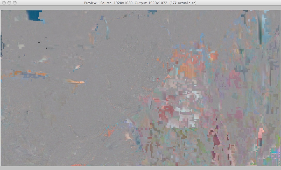

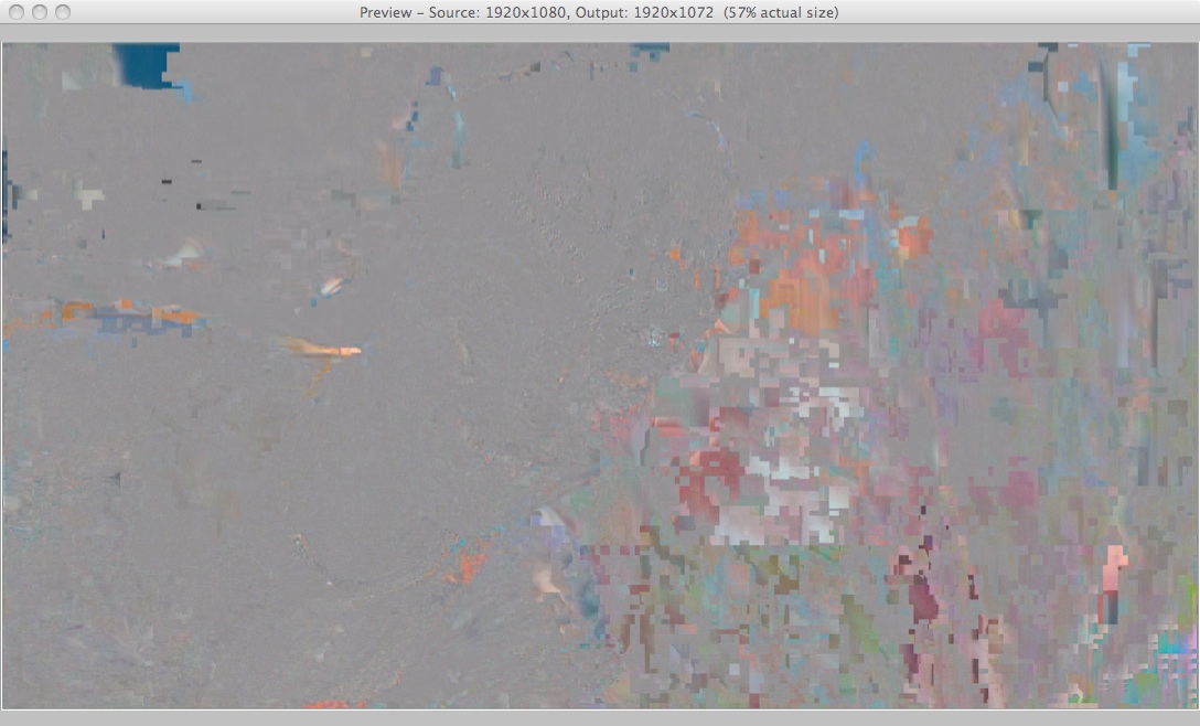

Ok Kristine, i'm still getting the same grey picture in Handbrake, it's even worse with Avatar. The .mkv files seem to play ok, albeit a little slow, in VLC and Divx player, but won't play nice with handbrake. I've attached a screenshot of the handbrake preview window, hopefully you can suggest something.
Thanks again, rdb71
Thanks again, rdb71
What version of VLC and Handbrake do you have installed? If they are not the latest, then I suggest uninstalling them and grabbing the latest versions. It might be worth trying the nightly build on Handbrake.

Thanks for your reply Kristine. I have installed the latest VLC and the nightly Handbrake build with no luck. Still having the exact same problem. I've searched the forums here there and everywhere and can't find anything about getting a grey picture preview on blu ray or even dvd. Seems a bit strange as I can't believe i'm the first person this has ever happened to? I think i'm going to have to post my issue in the Handbrake forums. Thanks you for your help anyway 🙂
I get it too, especially with MKVs made with MKVMerge on the Mac. It's something about the preview not being able to grab the right keyframe. The actual encode is fine, and the Live Preview works too, but it gives the autocrop a big headache. I usually just flip through the still previews until there's one where I can see where the black bars are, then crop manually.
I have the exact same problem on many of my .mkv files made using MakeMKV but similar to you, the encodes always come out fine--just have to manually crop. Weird think is, if I move through the picture preview manually, there is always one snapshot that is not pixelated/gray--use that to manually crop.
