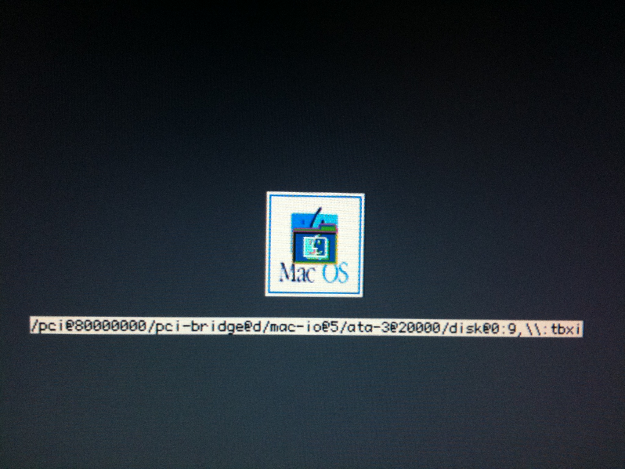

I put in an original Mac OS 9 CD, but I get sent to some weird firmware loader. I typed "mac-boot" and pressed return, and saw the attached screen. I looked up this weird code on the apple site and it means "no-boot".. whatever that means??

you just need a valid startup disk. since you don't have one, i dont know what else you're asking for here. pram has nothing to do with anything.
errr, I guess you didn't read my post. I said I have an "original" i.e. official, valid, authentic OS 9 CD...

You don't need a firewire drive... just a firewire cable that will connect your G3 to your MBP. Once connected start your G3 while holding down "T"... your G3's hard drive will appear on the desktop of your MBP. Restart your MBP and boot from the install DVD you have... then choose the G3's HD to install 10.4 onto. Make sure you format the drive to Apple Partition for PowerPC startup instead of GUID for Intel startup.
Feel free to PM me if you have questions.
Problem resolved - it was a bad stick of ram. Replaced it with standard PC133 SDRAM and it booted fine 🙂
