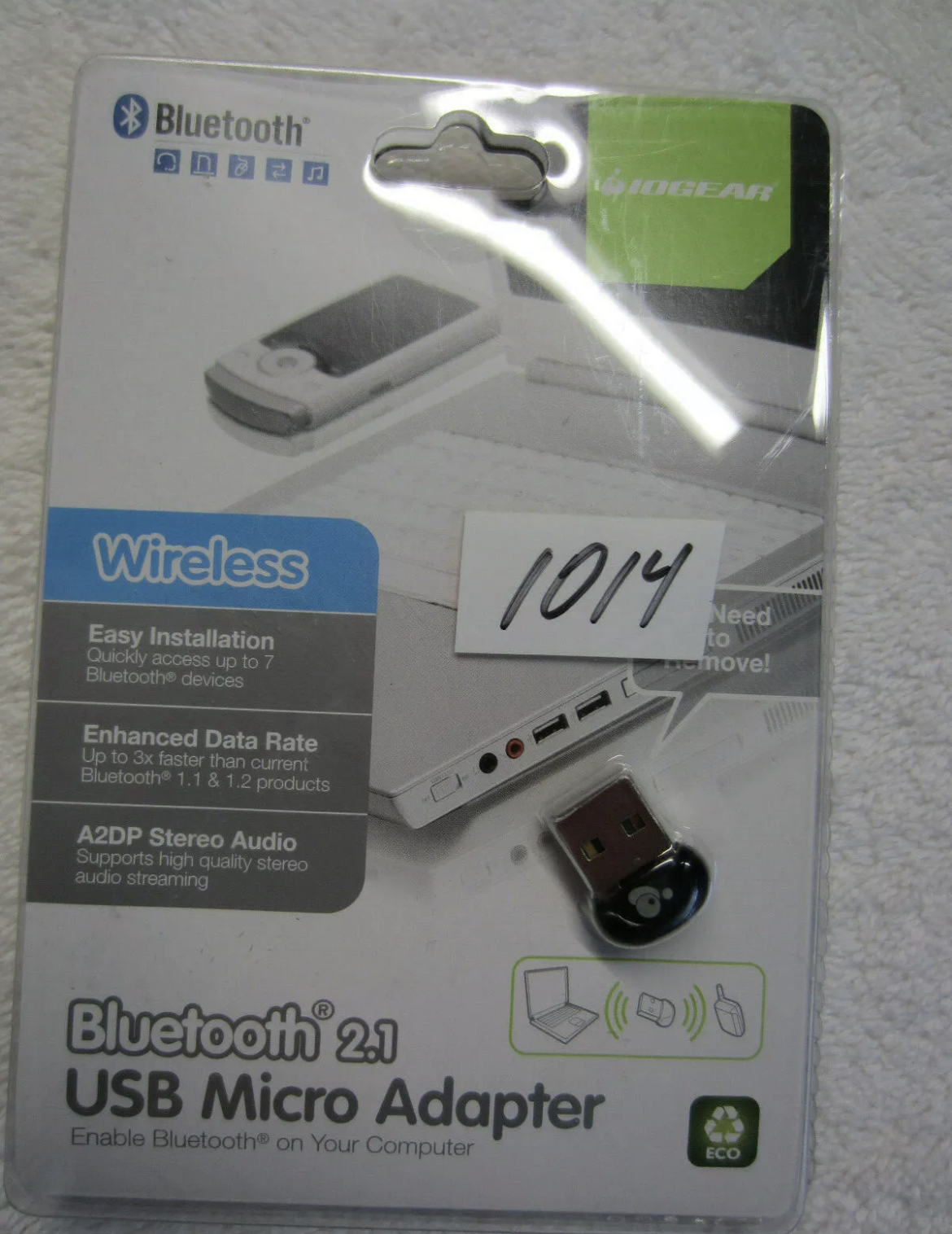

I the one pictured here. I have one for my Power Mac G5 and one for my G4 modded Pismo. Both are running Sorbet Leopard.
