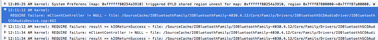

Sorry for the rehash, but I can't find the bluetooth explorer. I am having the same problem with my Jaybird J3's. They pair and connect but wont send audio. They actually prevent iTunes from progressing the song when i choose "use as audio device". I found the following error in Console, but can't find anything in google about it.
