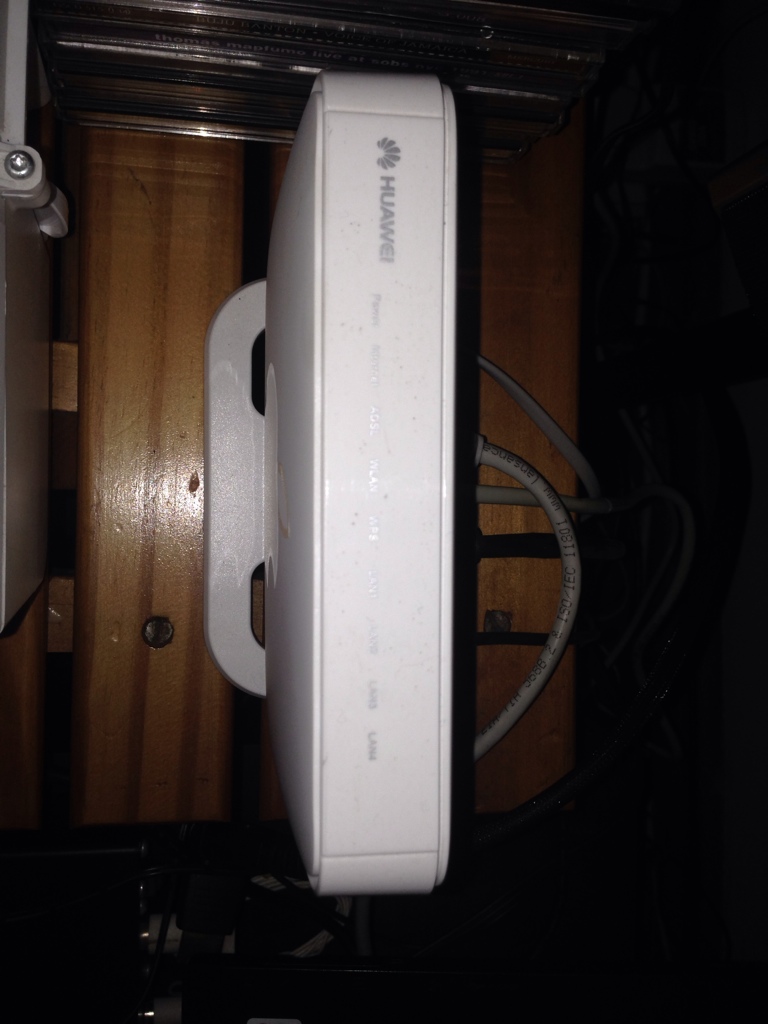

I use a Huaiwei wifi router and I don't know how or if at all there is a way to change these settings
Tulani...Check the model number of your router (probably on the back) and download a copy of the manual. Inside you'll find instructions for making changes to your router's settings. You'll need to log into the router to do this.
Have a look through the link/thread I posted above. You may need to change the channel or possible change the g/n broadcasting of the router.
Good luck. And remember, it's just an idea to help you out....doesn't work for everyone.
Ok thank you.
I might not go to far though. You won't believe how basic the manual is. But the gadget itself is so compact and versatile.
Once again thanks. I take all replies and contributions here with all respect.
