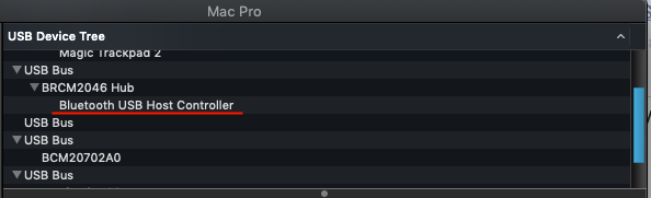

And it does work just fine on my mac pro 4,1/5,1 running Mojave.

And that's why I specifically mentioned that it works just fine for me.
