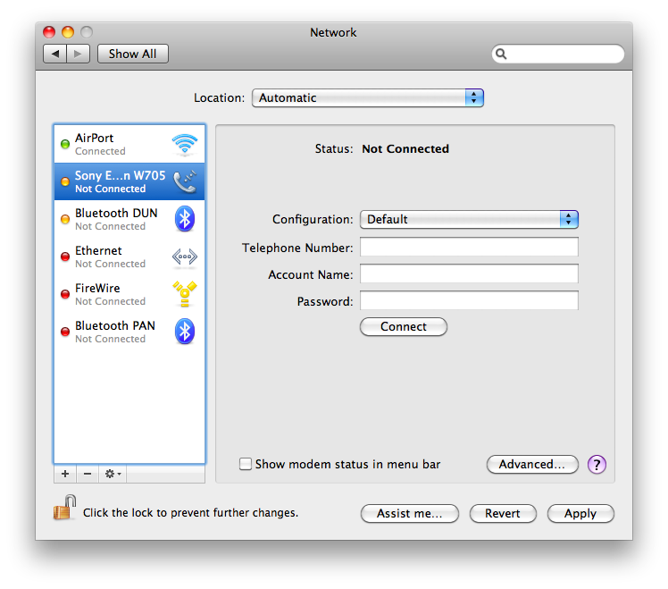

Hey, glad someone else is trying to resolve this issue too. Thanks for the quick reply. I tried connecting USB in the past and I tried again now. But I am struggling.
I go into System Preferences ---> Network --> + --> (Missing USB).
I think my issue is not having EnV Touch USB drivers. I remember having this problem when I got my phone too. Can't seem to find the drivers online for Mac.

Sorry, I can't help with that; I'm using a Sony Ericsson device and it works without drivers.
How did you setup the USB network connection then? Maybe I don't need drivers either.
It automatically appeared in the left pane of Network Preferences as soon as I plugged it in.
LOL. Well that is nice and convenient. I'll keep looking and post if I find anything.
Turns out there is not a Mac Driver available for the EnV Touch. That is why i can't find it. Out of luck I guess.
