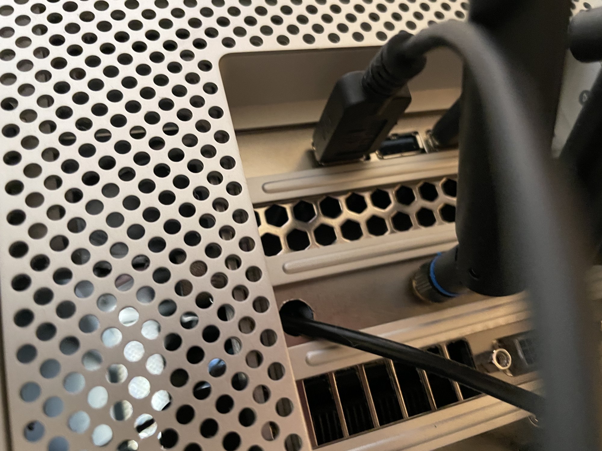

I purchased this Wifi/BT card in 2021. I've used it in both Mojave and now Monterey.
You have to disconnect the internal Wifi/BT and then run this extension out the back of the computer somehow to plug into a USB port for BT to work.
You need the extension cable because the included cable is designed for an internal Motherboard USB header which the CMP is lacking.
I had to drill a hole in the card to pass it through the back.
The advantage is the external antennas. The Antenna at the bottom of the card is the Bluetooth Antenna. I imagine all you need is an SMA extension like this to run the antenna where ever you want for coverage.

Interesting info. I already have an extension aerial for my built-in BT, but it doesn't seem to be particularly good, and as far as I understand it, the longer the aerial cable is, the worse the reception due to signal attenuation.
That's why I was wondering about the USB dongle BT adapters - because I can run a long usb cable, and put the BT adapter on the end / plug a hub in at the end and plug the BT into that (a lot of enthusiast mice come with a male to make usb adapter, so you can plug their wireless dongle onto the end of a usb cable).

Well, I've just taken a section out of my BT cable link, removing the original extender that went from the combo BT/Wifi card to the internal antenna, and now the cable to the PCI plate is plugged directly into the card, so hopefully that'll deal with some attenuation issues. I'll test it out.
By way of comparison, previously I could have my iPhone (OG SE) playing audio to Beats Flex, and be on the floor below, and out in the carport (concrete slab above), and audio would keep streaming. With the Mac and those same earbuds, I could walk to the next room on the same floor and it would start cutting out.

As a followup - I'm astounded by how much better the bluetooth is now I've removed one connected section from the cable.
So before I had WIFI/BT module plugged into the original BT extender "ex1" to get across to the original BT aerial, then a wire from the end of that extender to the PCI plate "ex2", then the external aerial with its cable plugged to the PCI plate "ex3".
In attempting to disconnect ex1 from ex2 (those tiny little connectors 😡) the one on the end of ex1 just popped off the end of the wire, as the solder disintegrated. In for a penny, in for a pound, I disconnected the WIFI/BT module, disconnected the remains of ex1 from it, and connected ex2 directly.
Whereas before I could barely walk more than a couple of metres from my machine without my Beats Flex cutting out, now I can walk down stairs to the floor below, and bluetooth keeps playing - so it has roughly equivalent performance to my OG iPhone SE.
So, a good result overall.
