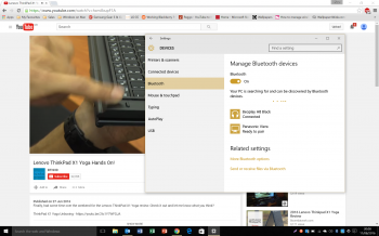

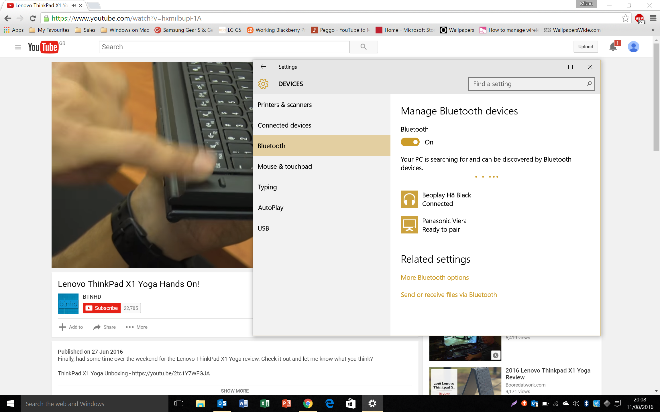

Okay guys I've noticed a bug on Windows 10 bootcamp came across it purely by accident as I was frustrated to get to the bottom of this sound drop out on BT headphones when connected.
Whenever I go to Settings - Devices - Bluetooth window (see image), the connected BT Headphone audio starts to stutter and it only happens on this settings window nowhere else!!
At first I thought it was general bug in Windows 10 but when tried to replicate this issue on my other windows 10 laptop (acer) there was no audio stutter on the connected BT headphones when I went to this settings window.
I could be wrong but I think this bug effects anyone running Windows 10 via bootcamp on Mac. Anyone else want to confirm or unconfirm what I have discovered?

I'm having the same issues with Bluetooth and Windows 10 Anniversary Edition. My connection always drops and reconnects. I think most members in this forum use regular headphones because it seems like nobody else is having this issue. It's a good thing that we still have a headphone jack!

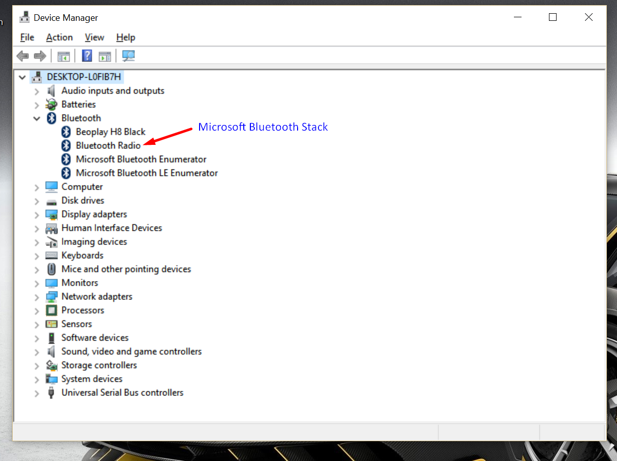

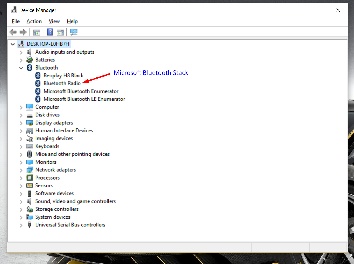

Okay I stand corrected this is definitely a bluetooth driver issue, although we are led to believe that apple have updated all their drivers in BootCamp V6 to be compatible with Windows 10 it seems the Apple Broadcom Built-in Bluetooth driver is NOT Windows 10 compatible!
Although BootCamp shows its installed the bluetooth driver but it is NOT and even when I do it manually via device manager it installs but does not work the "Apple Broadcom Built-in Bluetooth" icon has a yellow warning triangle on it.
So basically when you try to update the driver via device manager Windows defaults to standard Microsoft Bluetooth Stack - bluetooth radio. see attached image. This driver actually works very well other than what I have already stated in my last post that the audio stutters when Bluetooth devices settings is open.
It's frustrating that apple don't really care much about Bootcamp drivers and take their sweet time to update them. I don't understand the logic as the end user will have a poor experience with Windows on Mac, then what's the point of even providing bootcamp?? Or is it so that because of the poor experience the end user will stick with Mac???
