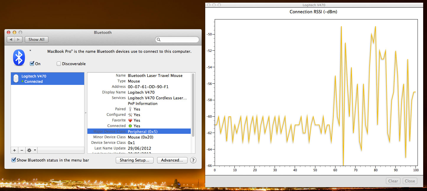

    Bump, as I'm experiencing this from time to time.
    Just found something in Bluetooth preferences, looks like signal strength. Could you please check yours ? Even if you don't experience this. Is your signal constant ?
    It drops on mine, depends if I move the mouse or not. Lion, 10.7.4, all updated.
    Thanks.
    To access this, select your mouse, on the bottom -> Settings icon -> Monitor Connection RSSI
    BTW.
