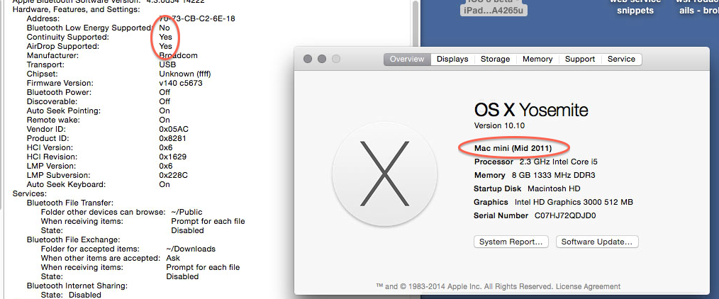

I've not got any iOS devices running the iOS 8 beta to test it at the moment, but my Mid 2011 Mac Mini is saying No to Bluetooth LE and Yes to Continuity...
This doesn't seem to make sense if Bluetooth LE is a continuity requirement or have I missed something?
Some continuity features work without Bluetooth LE such as the calling and sms

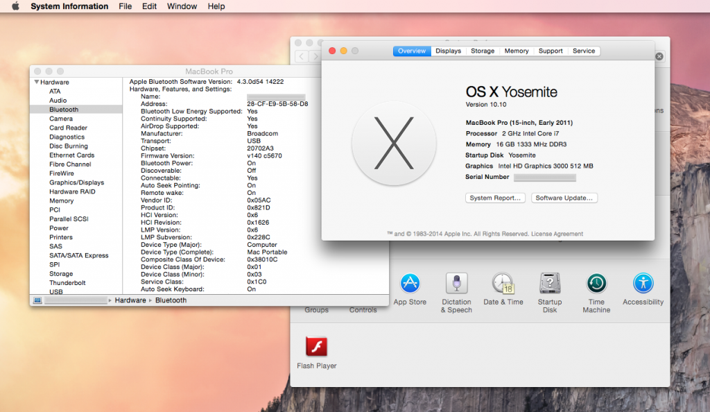

My 2011 MacBook Pro 15 has a 2012 bluetooth/Airport card in it, as that was all I could get when I repaired it. I get this in System Profiler on 10.10 DP2, so it looks like some Macs will be somewhat upgradable hardware wise.
Interestingly I remember hacking Airdrop back on Lion on an upgraded 2006 iMac with a 2008 Airport card in (so I could have wireless n) it and that worked flawlessly!
