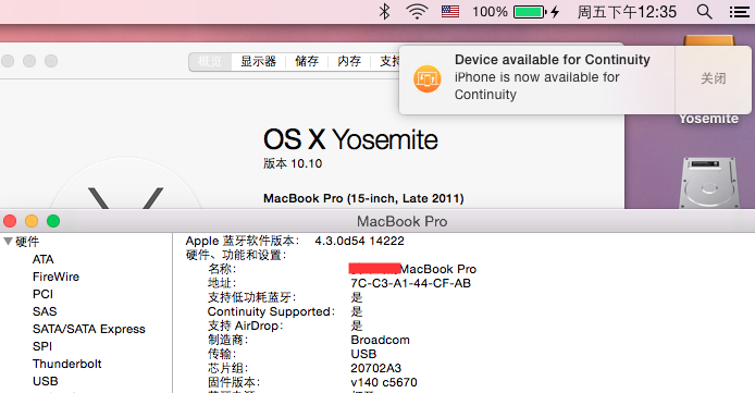

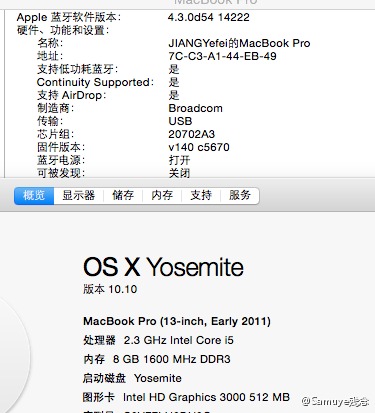

I bought the BT4.0 chips and replaced them in my MacbookPro 13inch early 2011 and Macbook Pro 15inch late2011.
It seems support airdrop and continuity.

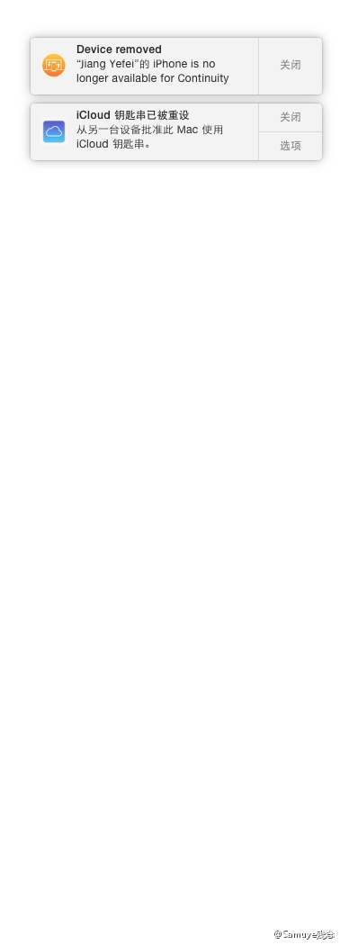

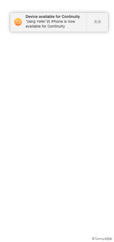

iOS8 beta 2 was installed in my iPhone 5s.
I can got the available note about Handoff, but I do not know how to active it.

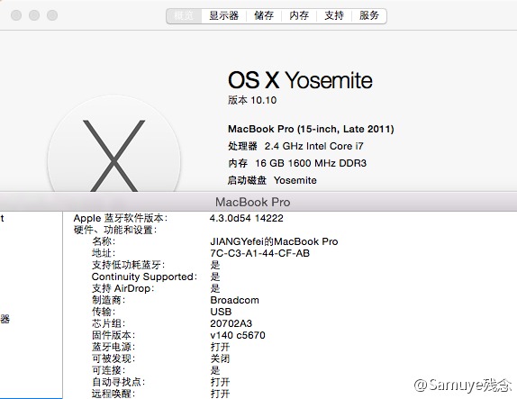

I think the useful information was displayed in English excepted BTLE support which means 低功耗蓝牙 in Chinese.
As u can c, the module of 2011 and 2012 mbp were the same size (not retina). so I do not know what iFixit mean. And the mean point is all the things seems support Handoff, but I can not use it.

In system preferences you need to enable handoff

My 2011 MacBook Pro 15 has a 2012 bluetooth/Airport card in it, as that was all I could get when I repaired it. I get this in System Profiler on 10.10 DP2, so it looks like some Macs will be somewhat upgradable hardware wise.

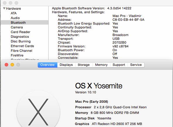

Wifi card from some new imacs/mbp > 802.11ac AND bluetooth 4.0
There are ways, using original Apple boards works Super easy in a 2008 MP, may be more trouble in 2009-12
Discovered first by Netkas
Perhaps a nice additional read, don't know if the sources are the same?
Sometimes macrumors aren’t completely right… My 2008 MacPro (so old) has a wifi card from some new imacs/mbp installed with adapter to mini-pcie slot. It gives me 802.11ac AND bluetooth 4.0, no need to remove old bt card, as new one is preferred over old one… Continuity is supported:
Read more here: http://9to5mac.com/2014/06/20/apple...der-macs-bluetooth-le-adapters-a-possibility/
~ Cheers

I sent Netkas the card, everything came from there.
I should have a USB BT 4.0 for Macs in next few weeks.
