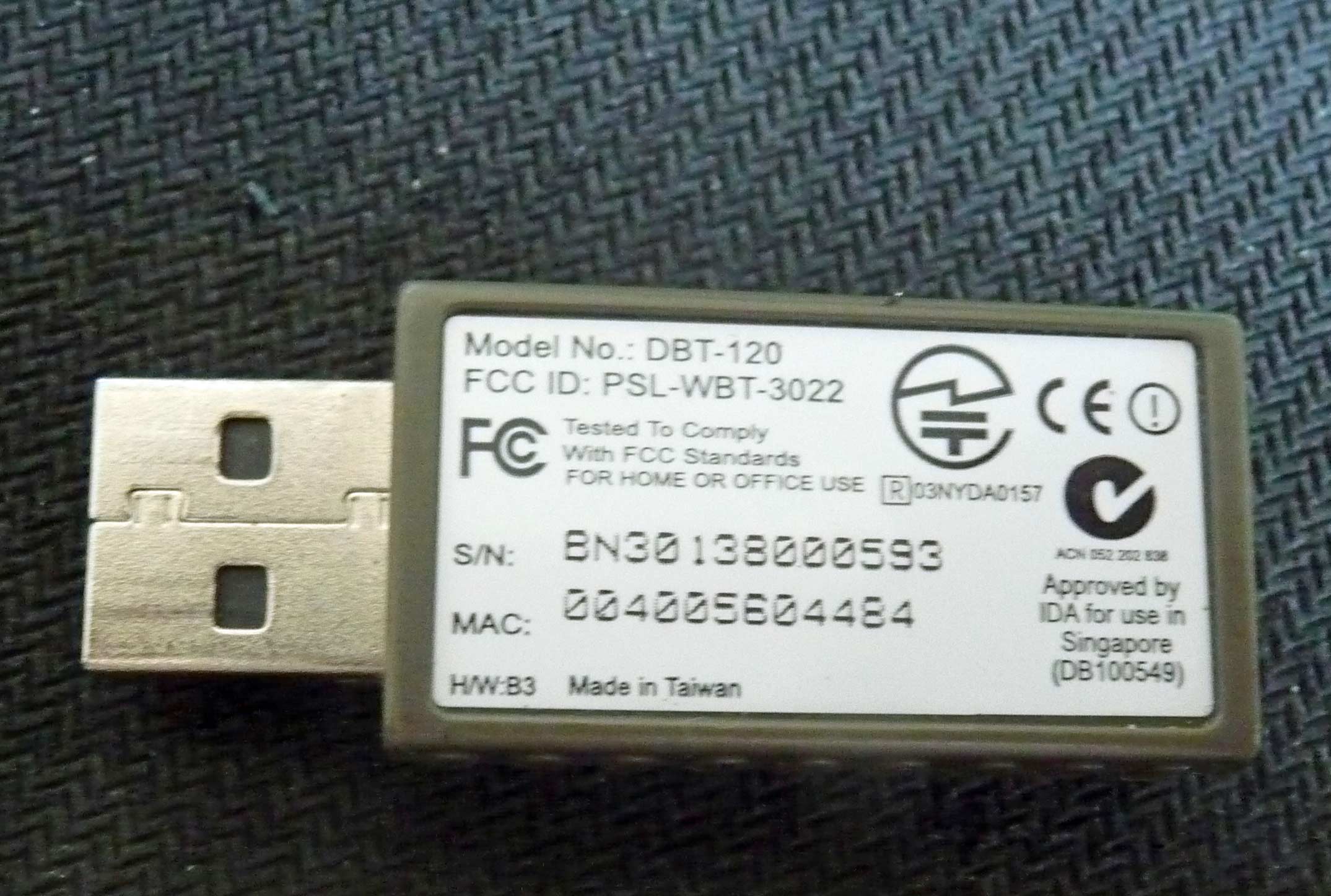

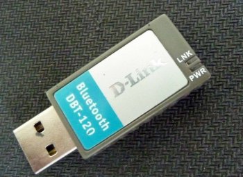

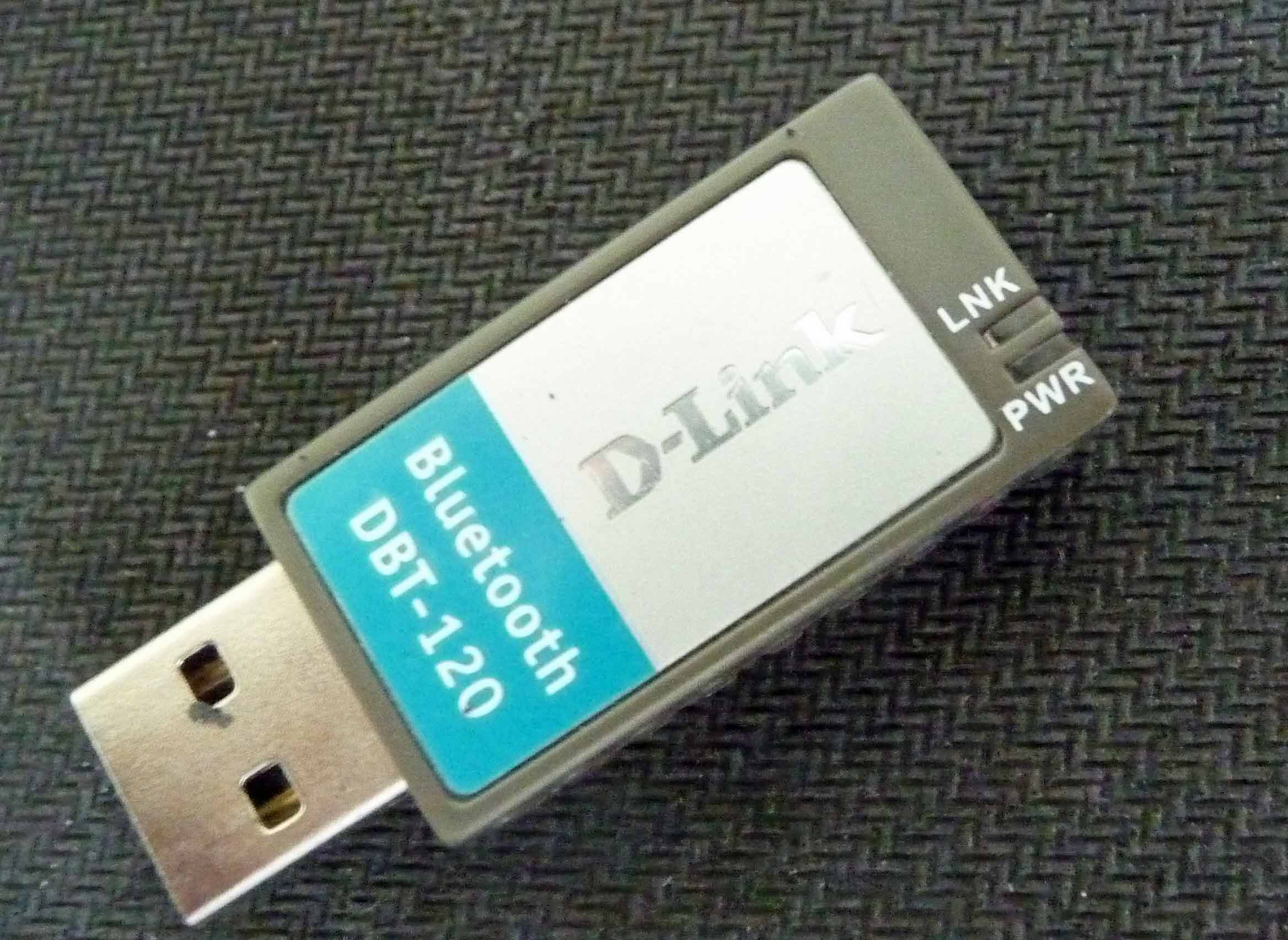

There’s an ancient D-Link USB BT adapter that was ‘blessed’ by Apple with an official firmware replacement. It keeps it live when asleep, so a connected keyboard / mouse can wake the computer up. A normal BT adapter can’t do this. This is the easiest / cheapest solution (about £10).
Yep, this one I believe.
There's also another almost identical marked DBT-122 which may be ok, perhaps someone could confirm if so.
3 years later... that D-Link DBT-120 / 122 costs about AU$50 on eBay. Just looking as a possible upgrade for my iMac G4...
