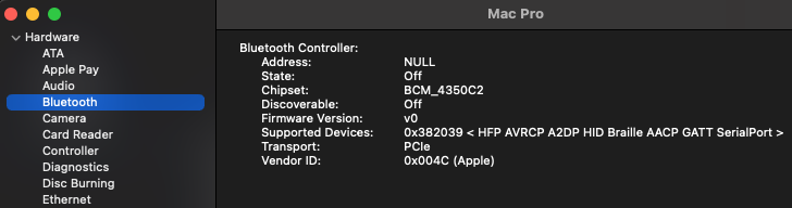

Even after removing internal bluetooth mini-board about my Mac still shows it as present (is it normal?):

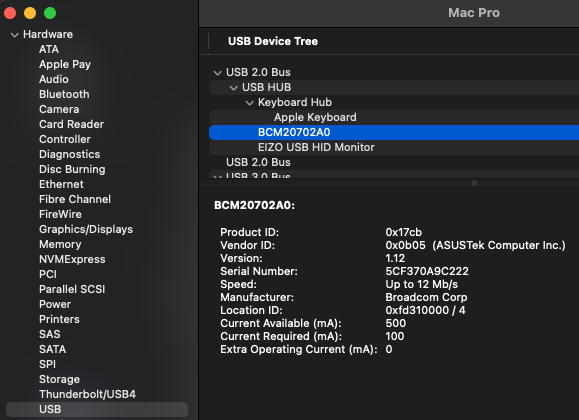

The dongle is seen:
But it does not appear in the Bluetooth section (se the first image above) and bluetooth does not work at all.

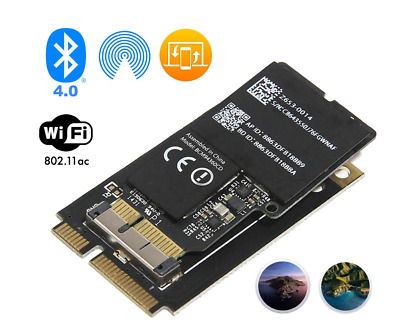

I used the wifi upgrade kit from eBay which replaces the built in wifi and Bluetooth and connects to the stock antenna.

This one should work:
BCM94360CD. Connect the wires as instructed, be careful connecting the bluetooth antenna wire, the connectors at the ends are extremely fragile. A tweezer helps with this.
This is the old one BCM94322MC:
And this is the new one installed:
The old bluetooth module is not used anymore:
That "BT" cable connects to the extension cable coming from the BCM94360CD.
