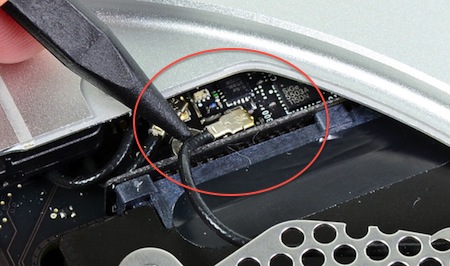

What exactly am I looking for inside that would affect the bluetooth? The connection for the bluetooth antenna? Anyone have a picture of what it may look like/

This is the bluetooth/wireless connector:
Make sure that it is connected correctly.
Thank you, problem fixed. I opened it up, and as per that picture, I made sure the bluetooth/wifi connection was secure; it was not before.
Works perfectly again!
