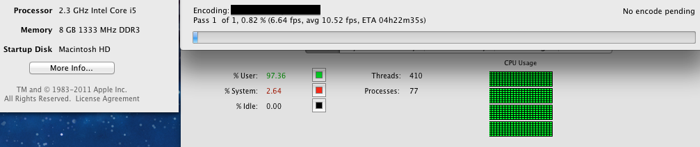

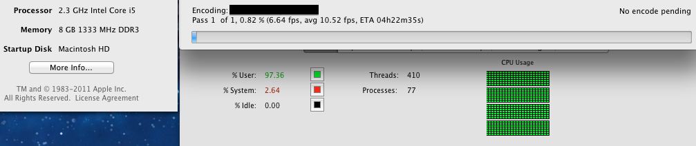

Piss slow on the i5.. and handbrake is lying in that screen.
I've directly compared my i7 iMac to my i5 Mini... for a given 1080p encode the i7 iMac took less than 2 hours, whereas the Mini took slightly over 6 hours.
Set "Maximum B-Frames" to
(number of real CPU cores on your system without HT).
On my QuadCore i7 MBP, i set this to 4.
Set "Adaptive B-Frames" to "Optimal" and "Adaptive Direct Mode" to "Automatic".
Make sure you have enough free RAM, if you encode HD video.
Your Activity Monitor should show you something like this:
(see attachment two)

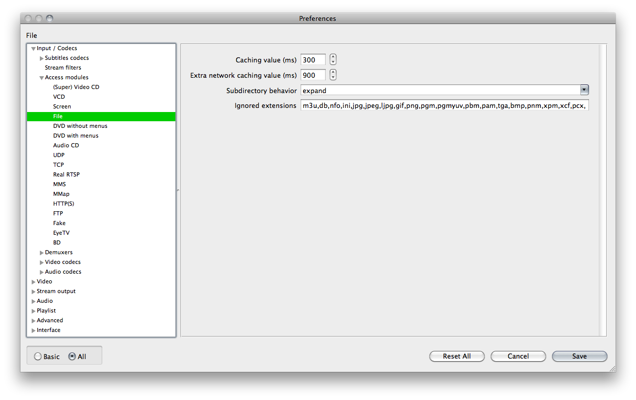

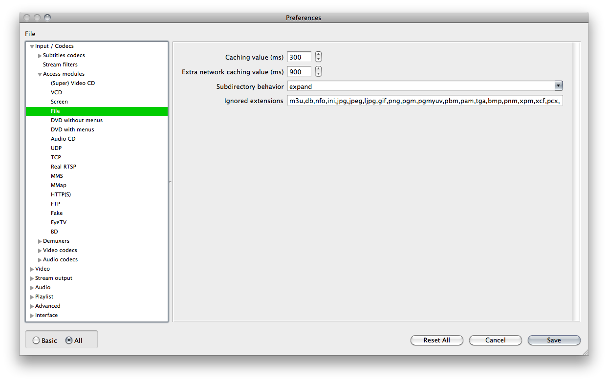

Playbacks in VLC choke on RF 10 encodes. I'm surprised that VLC and HD 3000 chokes on these files. RF 15 und up, no problems...
Higher bitrates require larger buffers. Set the file cache value to 600, 1200 or 2400 milliseconds (ms), and restart VLC. That should help with high bitrate files. See attachment number one.

I changed the VLC File Cache value from the default of 300 to 600, 1200 and 2400 and re-ran my original RF 10 sample. Stutter got much better at 600 but, not any better above that value.
