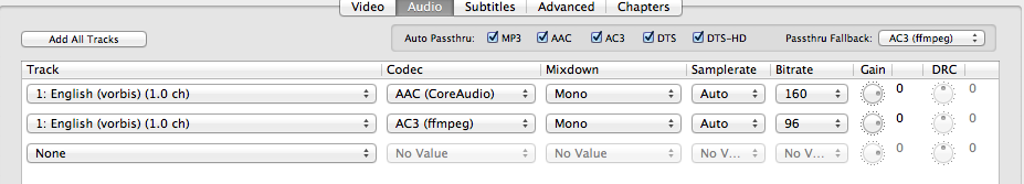

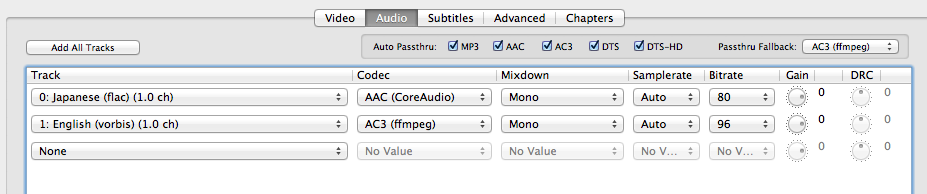

Last night I did my first conversion from mkv to m4v for movie called Rashomon which is in Japanese language. As much as I knew I tried to get Handbrake to include Japanese track plus English com. and also tried to include English subs as well which already were in MKV. But when I play this file in iTunes it only plays Japanese track for audio and no subs(although it does show English com and subs greyed out if one tries to select them). But on VLC it can play Japanese audio and can switch to English com too and also in Subs in VLC , I can have English subs showing.
So I just want to know what setting I did wrong that iTunes wont show subs and other audio track option can not be selected?

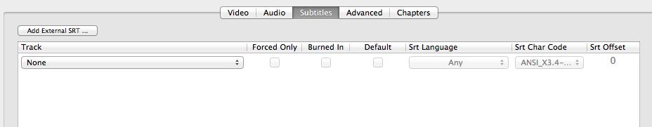

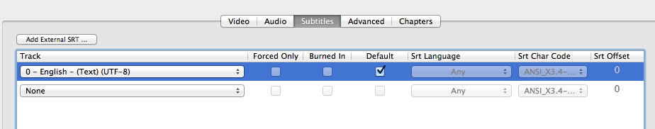

Here trying to post some screenshots. First are defaults I get under ATV3 preset and second 2 ss are showing what I think selected.
And these setting were the ones I chose
iTunes won't let you toggle subtitles.
If you have a foreign language film, just enable burn in for English subs (god forbid you like English dubbing).
Or use something like XBMC to view your films, then you can choose from a myriad of options.

You can only add "soft" subtitles to an mp4 (can select and turn on/off) if you mux in subtitle files that are in the srt format. You have the option of downloading the srt's from various subtitle sites or create them yourself (search this forum for how). You can use HB or Subler to mux them into the file.

as I posted the screen shot , you can see burn in option is greyed out so could not select that. Source file was MKV with subs in it rather than srt file. Which since then I have learnt is getting srt and then adding that as a external sub file in Handbrake.
What about having multiple audios?
