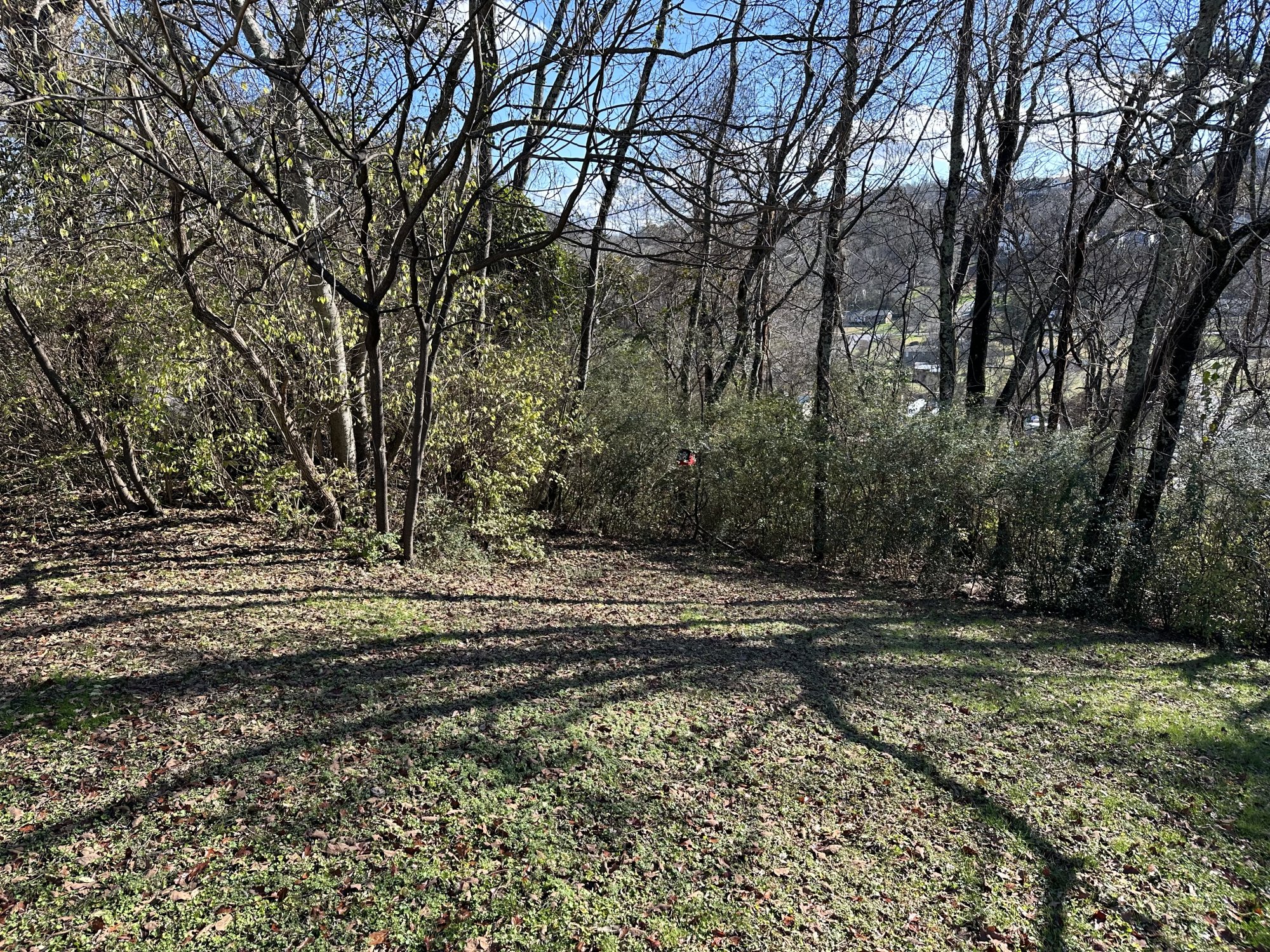

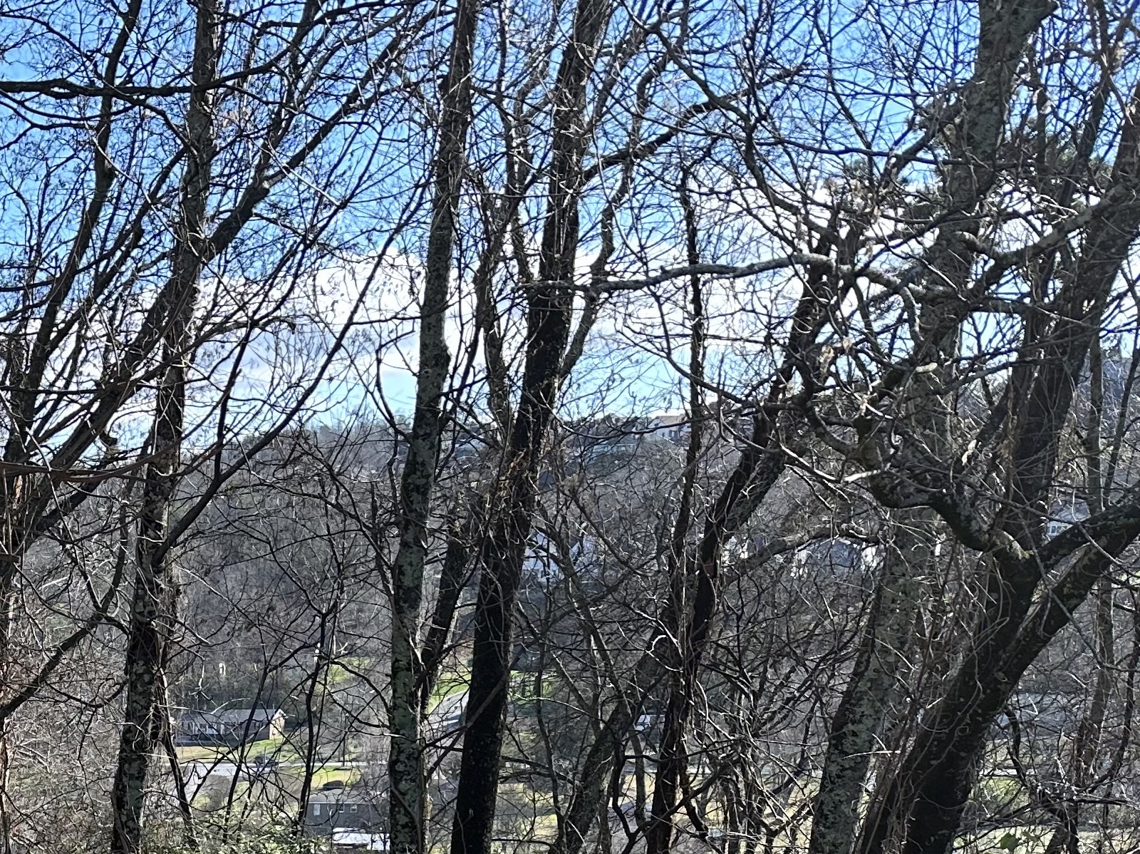

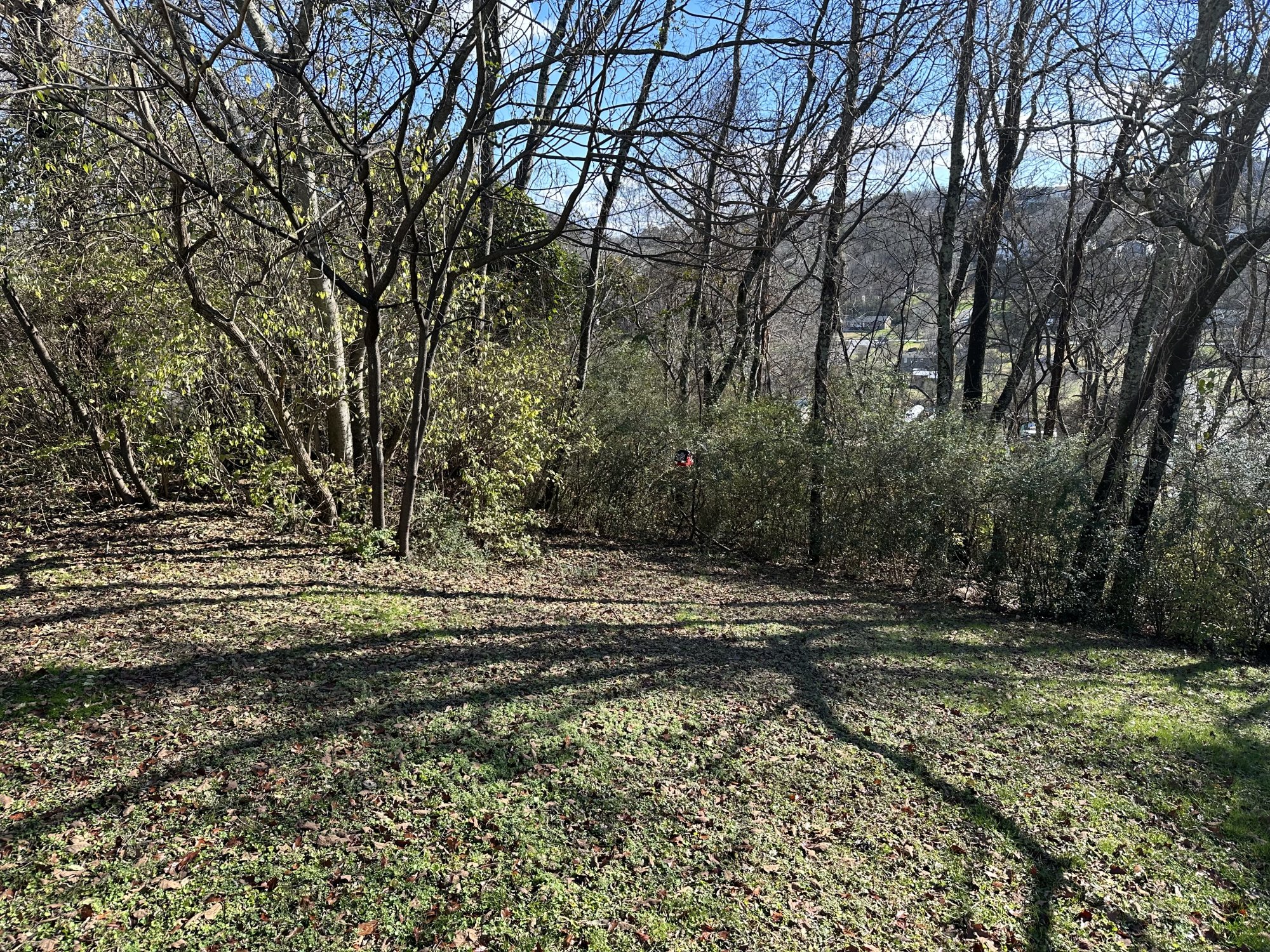

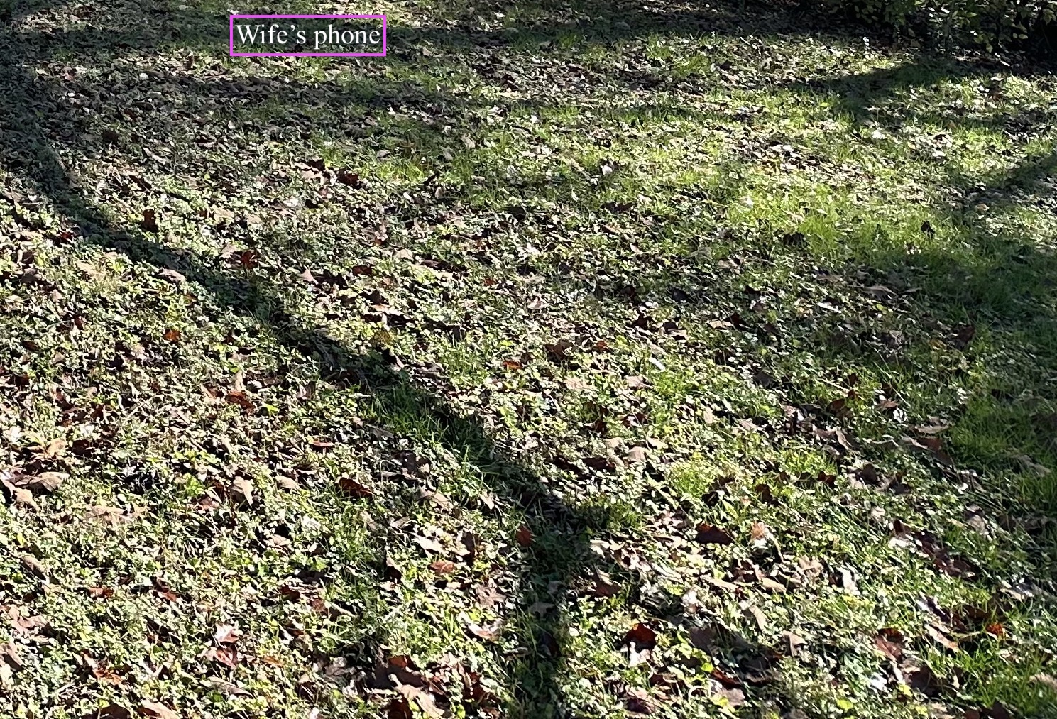

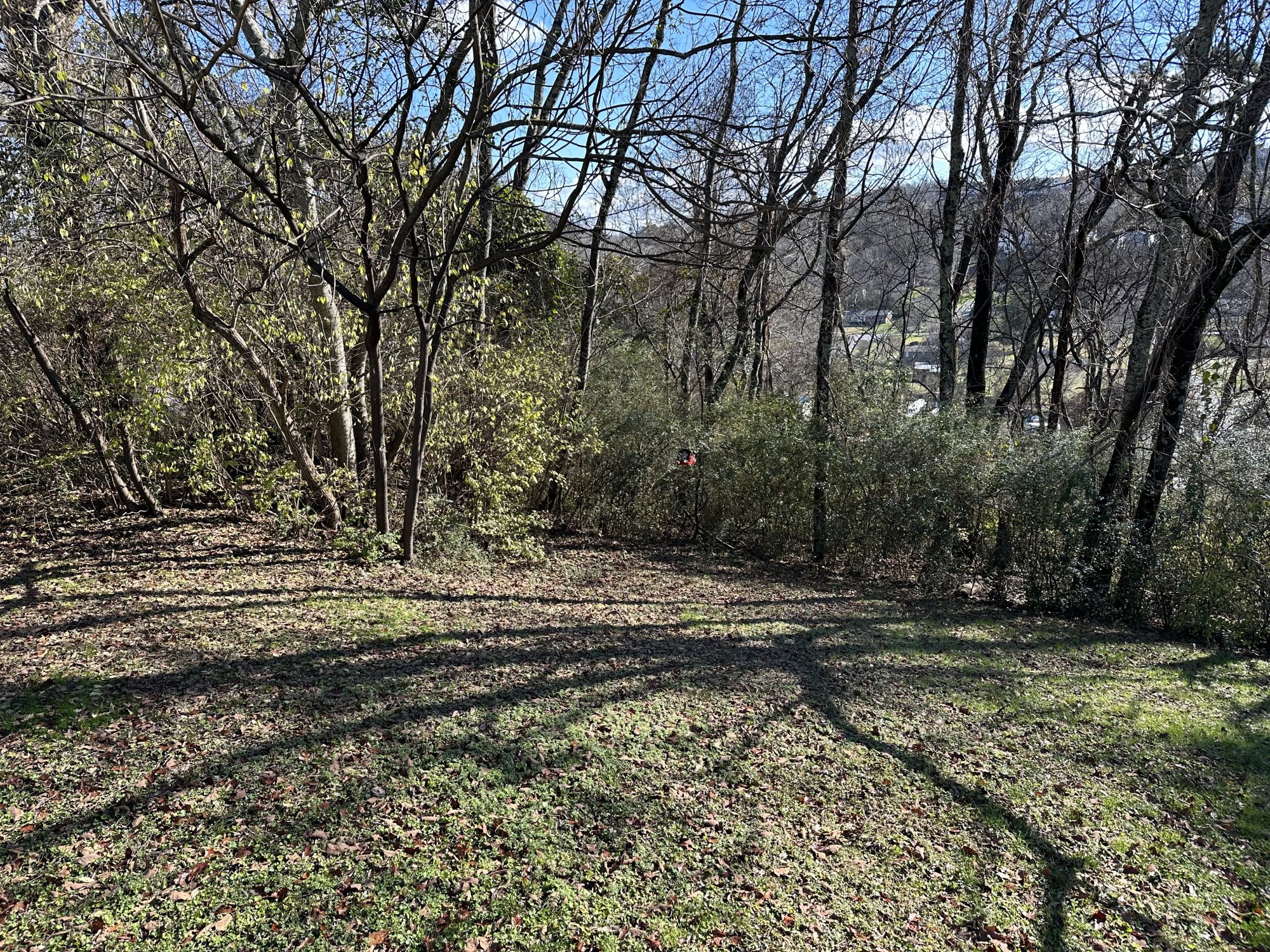

Below is a comparison between my iPhone 14 Pro (shown 1st) and my wife's iPhone 14 Pro (shown 2nd) that just arrived a few days ago. The full photos are followed by crops of the right lower corner.
My camera is clearly defective. I'll be sending it back to Apple for repair or replacement.
My 14 Pro:
Wife's 14 Pro:
My 14 Pro corner crop:
Wife's 14 Pro corner crop:
My 14 Pro:
Wife's 14 Pro:
But the upper right corner from your wife’s is more blurry than yours. I think it’s just the quality we can expect from apple which charges us 2k plus for a phone. 💁🏻‍♂️
Here are crops of the upper right corners. Mine 1st, hers 2nd. Other than a small difference in exposure, they look about the same to me.

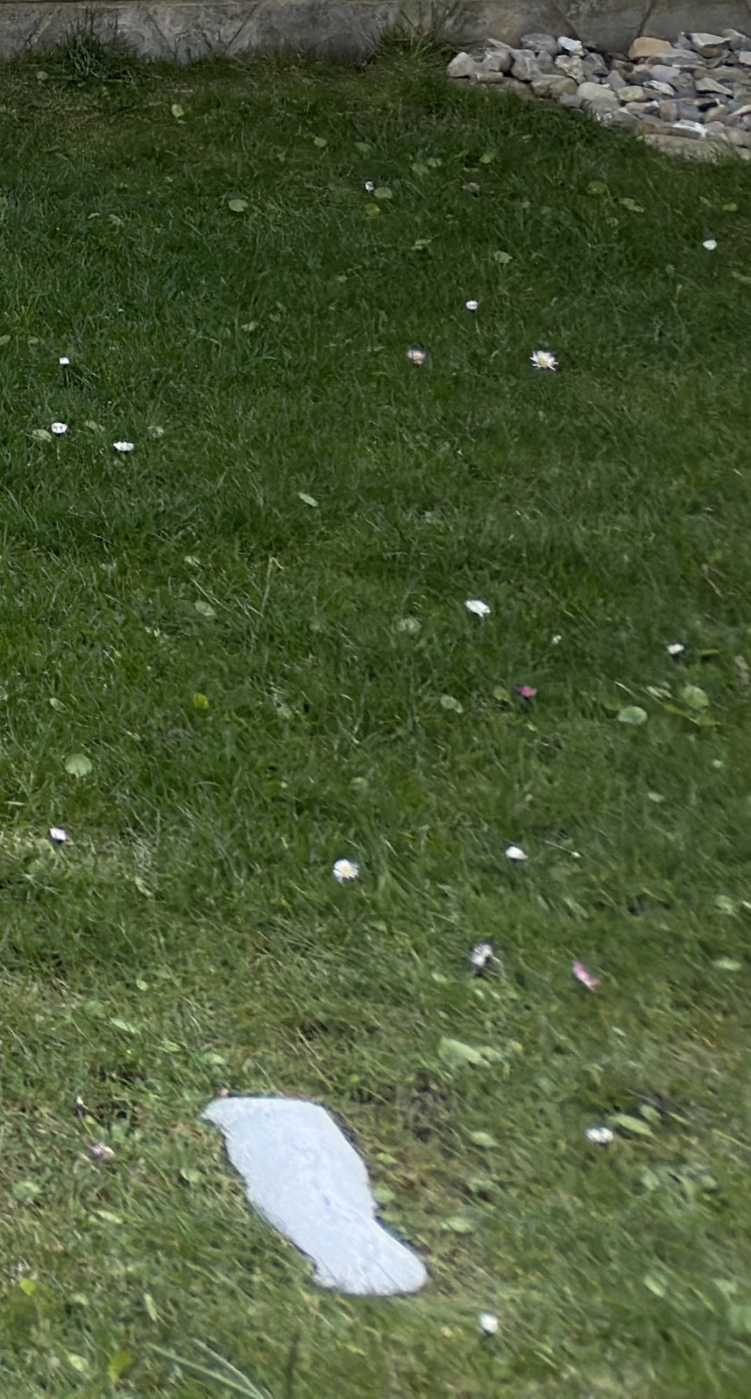

Hi there! I recently got an iphone 14 pro and I am experiencing the same issue. An out of cous right corner and a slightly less one on the left. By turning the camera upside-down the bottom parts are better so there is a consistent blurry corner on the right. Any update on your phone? I am contemplating if this is a common thing and if returning it’s worth it.
Well there is always some coma from the optics in the corners of all lenses, including those of DSLR’s. Only the Zeiss optics nave no coma. Also remember that the sensor in the new iPhone reduces motion via IBIS. Sensor shift image stabilization. So the sensor moves under the optics and at some point, the sensor could move further in one direction and pick up lens distortion from the optics. My iPhone 14 pro max (I have two) are similar optically. At times there is some distortion (depending on how much you shake during a photo). Put the iPhone on a tripod and use your Apple Watch (if you have one) to trigger the shutter and then inspect the photo. Level the iPhone and shoot a photo of a brick wall or chain link fence. And it also possible that the sensor may not be perfectly centered under the optics. So are these tests in 12mp or 48mp mode?
I have done them in 48 mp. I have seen even reviews with the same problem in their photo samples, that’s why I wonder if it’s just a characteristic of the lens. The thing is it’s that it’s consistent. It’ always on the lower bottom.

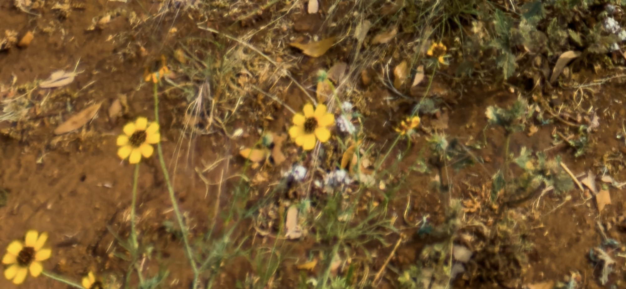

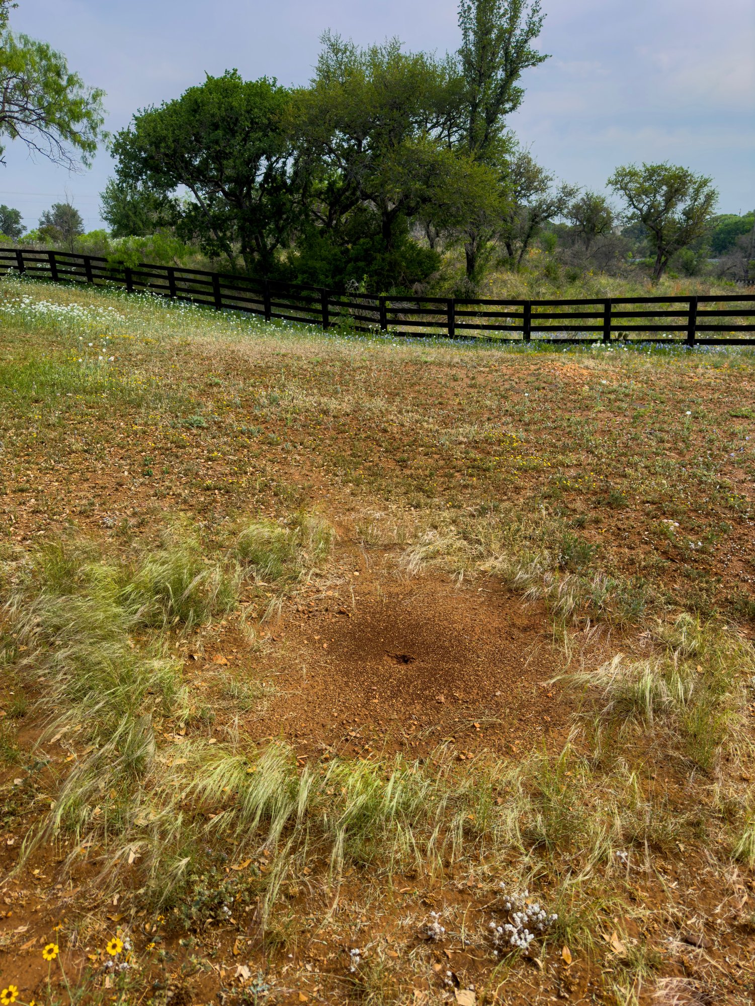

This is the best example that show the right corner once with the phone in the “normal” position and upside diwn after.
This is the best example that show the right corner once with the phone in the “normal” position and upside diwn after.View attachment 2187236
That’s a bit blurry. There appears to be a problem with the optics. Have you contacted Apple to get a camera replacement? My corners are somewhat distorted but mine is considered normal. Your corners are bad enough to where I’d request a replacement..

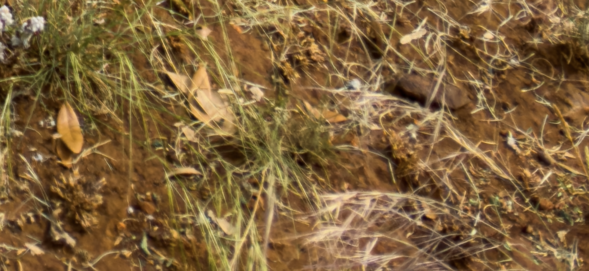

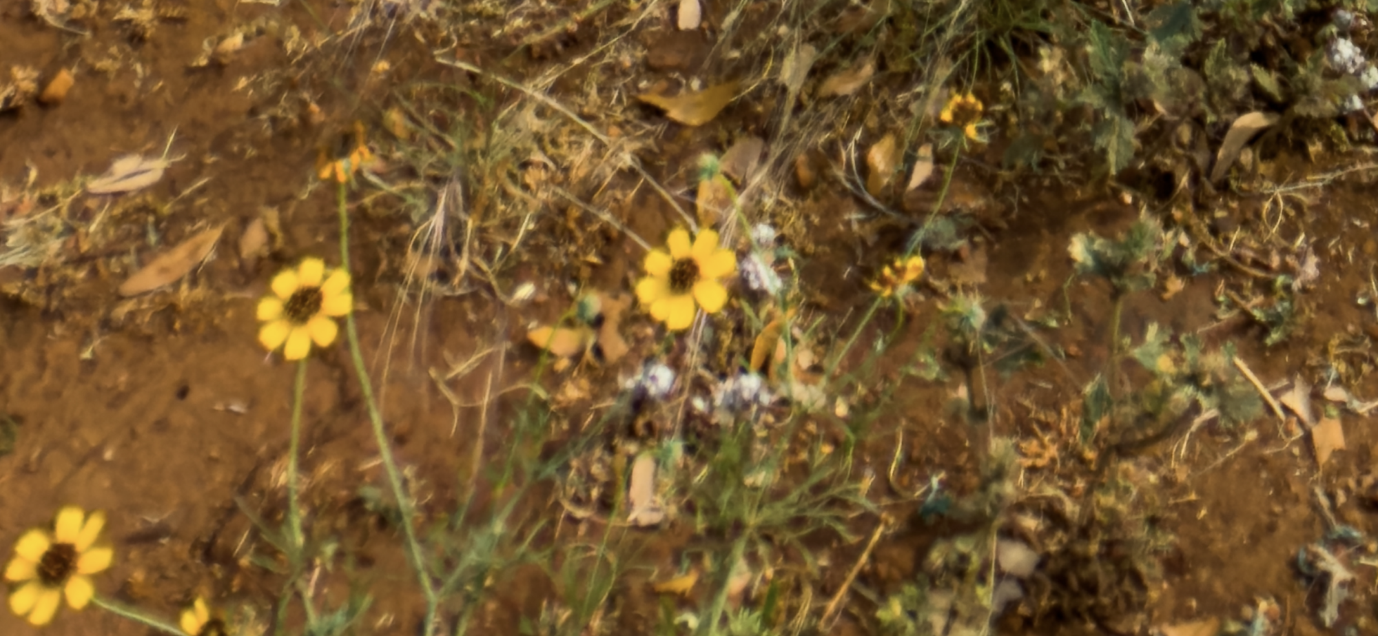

My sample and heavy crops of the lower left & right corners.
Left corner
Right corner
Left corner
Right corner
Thank you very much for taking the time. I really appreciate it. My samples are actually portrait crops of a landscape photo so basically my corner corresponds to your left corner wich seems more blurrier on your photo also. Also your top left corner seems blurry too but I can’t figure if it is from the wind. Can you please shoot another picture in landscape mode?
