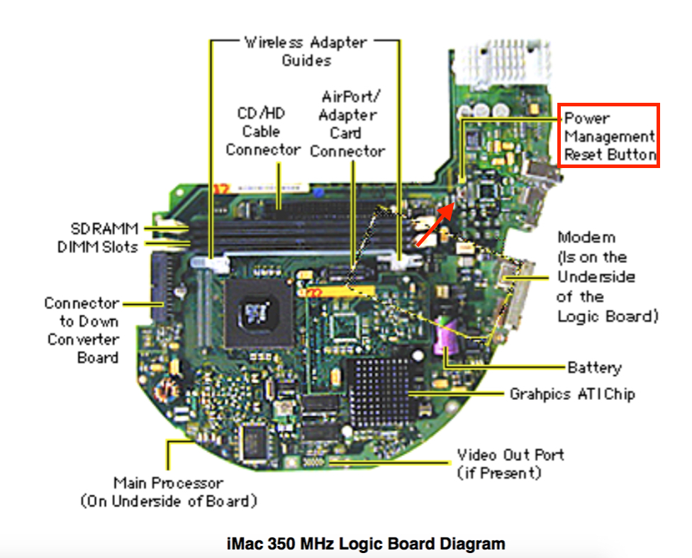

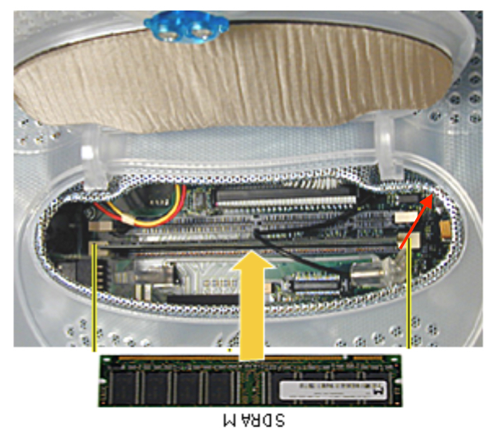

So, if pictures show the CUDA-button ("Power Management Reset Button") it might be accessed by a spudger or a wooden toothpick through the RAM-door ...? (otherwise no big deal to remove bottom and EMI-shield - especially if the battery is to be replaced)
CUDOs to @swamprock! :)
View attachment 832741 View attachment 832742

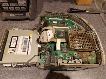

The iMac in your attachments is not a bondi. That's a newer slot loading iMac. Bondi's are in my opinion "dark teal" and are tray loaders only. They do not have a opening on the rear like the slot loaders for RAM, theirs come on a CPU card nearly identical to PowerBook G3s and is sodimm laptop memory.
This is how tray loaders open up and what the logicboards look like.
Reactions: bobesch
Uups :oops:, you're right and thanks for the link!
Actually I didn't take a look "under the hood" of my defective Bondi and another defective tray-loader yet! (Last year I got a non-working Strawberry tray-loader for 10€ too).
With the hints about CUDA-button, replacement-battery, keeping the iMac plugged-in for some time and how to disassemble the tray-loaders I'm happy now to know, where to start with.
The pictures I've attached came from the official Apple repair manual and yes, they show a Blueberry.
(It's a pity, there's no Bondi-color for the later slot-loaders, since the most annoying thing concerning the tray-loaders is, that they don't go into proper sleeping mode and the fan is humming all the time ...)

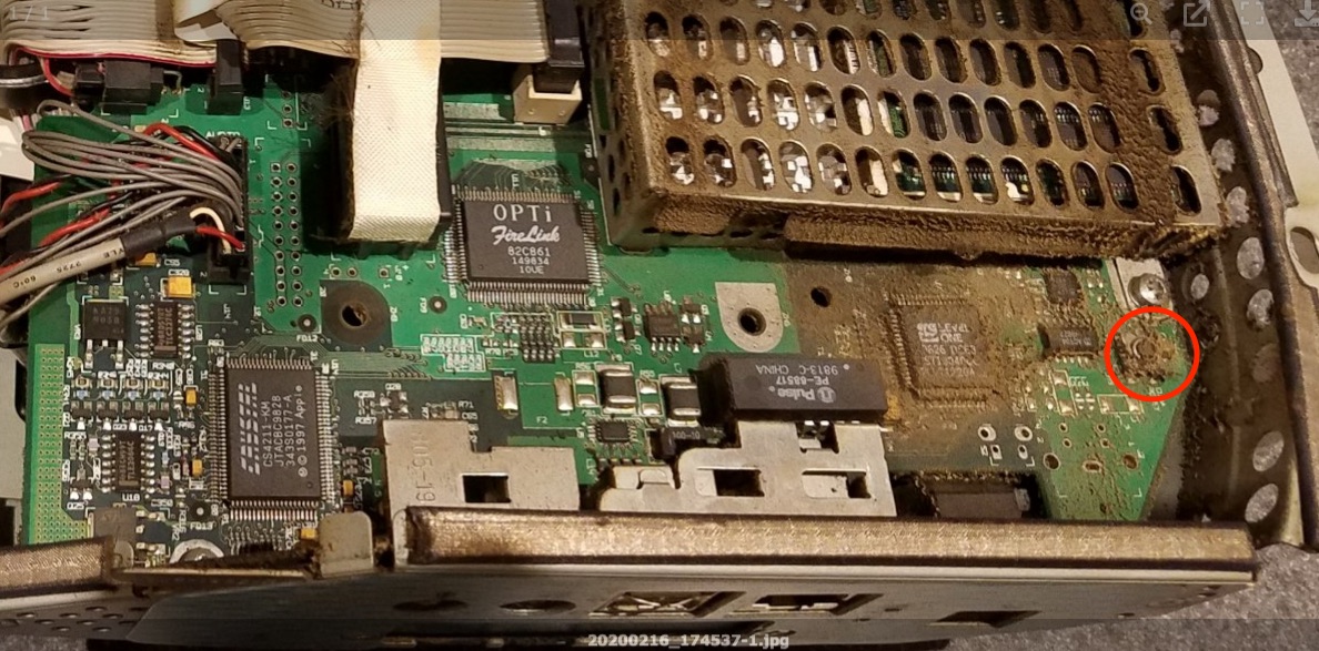

my Bondi iMac from 1998 (I thought it was a Rev B, but the tag inside on a ribbon says Rev A) wouldn't turn on. I followed the instructions to open it, but I don't see the CUDA button - what does it look like? can you show me where it is on this picture? I have ordered a battery to replace that. Hoping posting on this old one will bump to the top. I've never been on here before. and have not touched this computer in a while! Thanks for any help - Beth
Hi Beth & welcome, check out this Apple knowledge base article.
“reset button is located on the back edge of the logic board between
the modem port and the processor module.”
So with that bit of helpful knowledge, that dusty blob circled in red is your CUDA switch on the Rev A/B Bondi.
Assuming your CUDA reset & fresh battery is successful and your imac is happy again, since you have it apart, give it a good clean with some air duster and a CPU repaste. Just remove that aluminum cage there via two screws (I think, might be just one) and gain access to the CPU heatsink & CPU. Remove the heatsink clamp, pull the heatsink off, clean the old paste off both CPU & heatsink with some rubbing alcohol and q-tips, put a dab of new paste on the CPU and put er back together. My bondi rev B was very happy after that tune up and I bet yours will be too.
Best of luck to you. Hope it works out.
