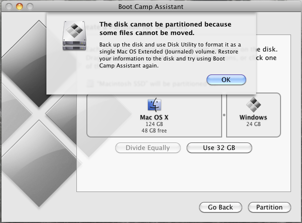

So I TimeMachine-d my disk and tried to install Vista with a 10gb partition. The Vista installer found the partition this time, but still wouldn't do it, saying it needed at least 14.7gb of free space do install. So I rebooted into Mac OS X again, and went to Boot Camp Assistant and deleted the Windows partition to make a bigger one. So when I went to re-partition the disk with a bigger partition, Boot Camp told me this: [see first attached picture]

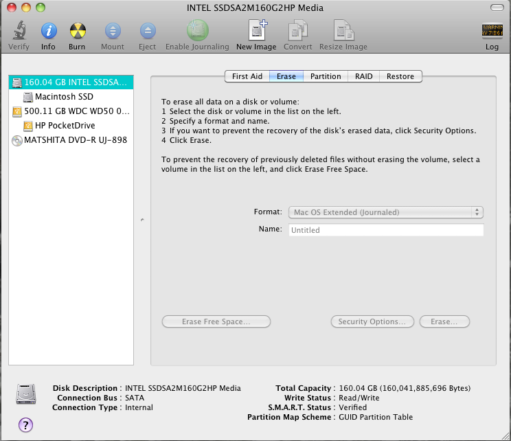

So, I went into Disk Utility and I couldn't reformat my main disk 😡 [see second attached picture]. Suggestions?

So I booted up from the Mac OS X disc instead of my hard drive, erased/reformatted it into one big Mac OS X Extended (Journaled) partition (I had already Time Machine-d everything), then refreshed my system with the Time Machine backup, and tried the Boot Camp process with a 20-something GB partition. It worked!
