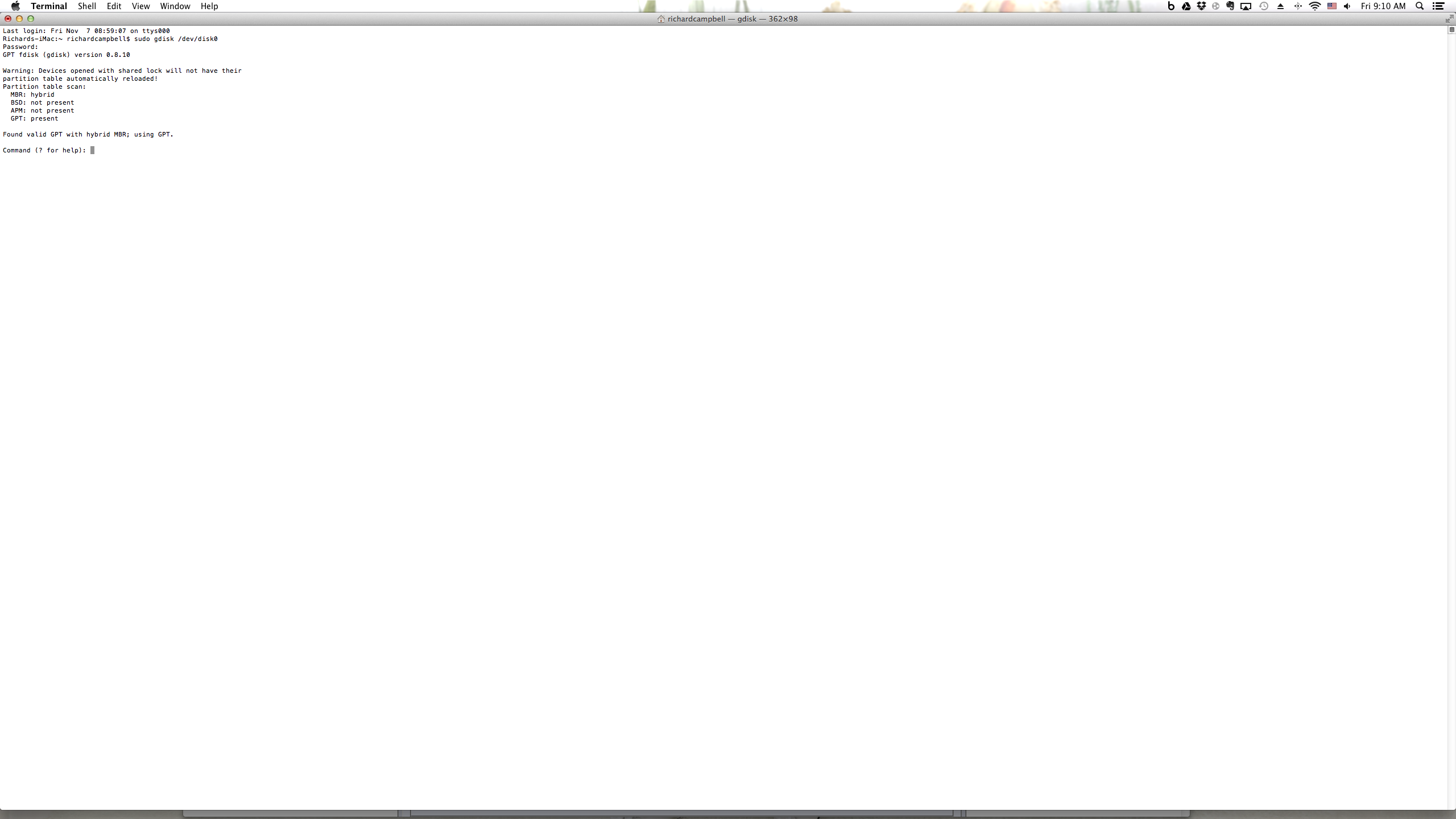

Desperate Help
I'm in the same boat as other guys
I can't boot to my windows partition
I tried gdisk and I got
this
Warning: Devices opened with shared lock will not have their
partition table automatically reloaded!
Partition table scan:
MBR: hybrid
BSD: not present
APM: not present
GPT: present
Found valid GPT with hybrid MBR; using GPT.
Command (? for help):
Please help I don't want to lose my Windows Data
this
MBR: hybrid
BSD: not present
APM: not present
GPT: present
To be safe, just download some backup utility such as Winclone to create a backup of your Windows partition. Then recreate your BootCamp. When you're in the step in selecting partition where Windows will be installed, select the BootCamp partition, format it (not delete), then install.
