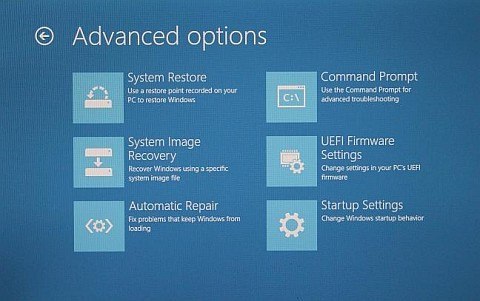

I had a similar issue and it was actually pretty easy to solve it. (I have Windows 8.1)
1. Insert your windows installation disk.
2. go to "fix your pc".
3. go to "Advanced options".
4. click on "Automatic Repair".
5. when the computer reboots, hold down the option key.
6. you should now see the windows disk.
7. boot from the disk and you should get into windows.
