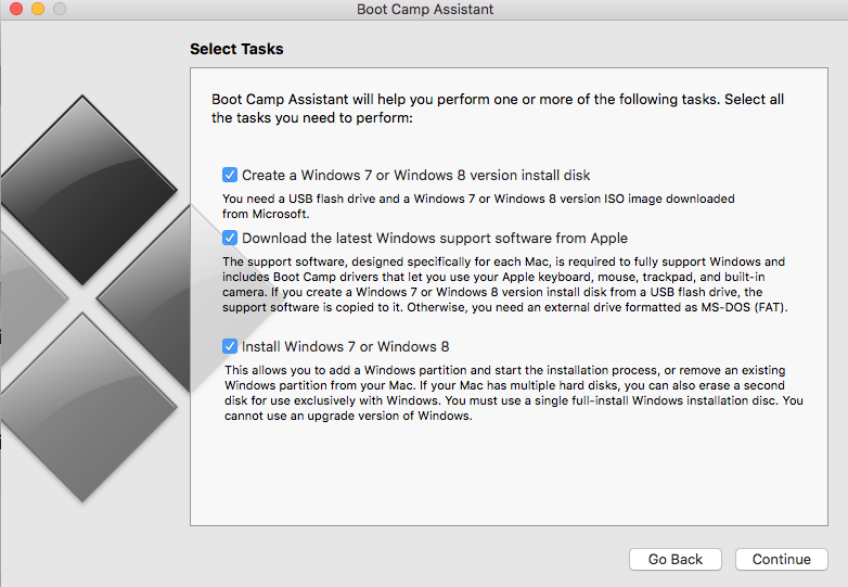

This iMac has an optical drive, so Boot Camp wants to boot from an external disc - which is defunct and not operable anymore.

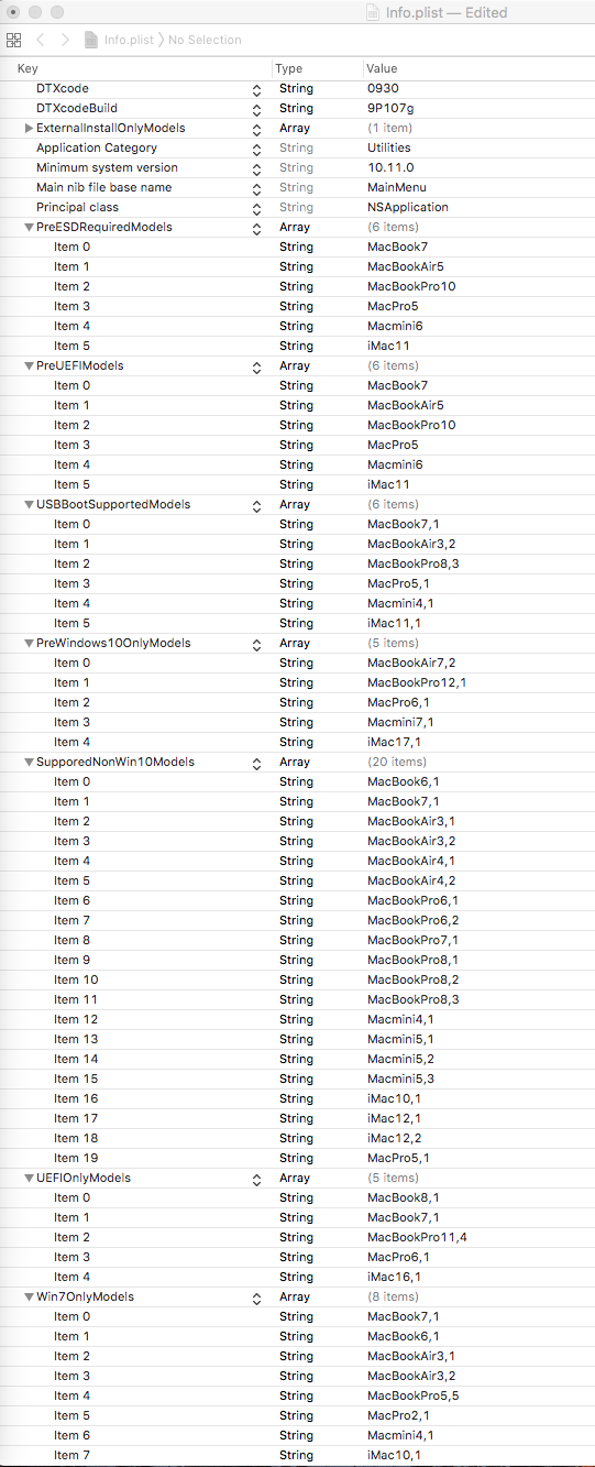

After reviewing other forums and MR, I've changed the Boot Camp property list (info.plist) using XCode to enable Windows 7 through 10 to be installed by USB (below).

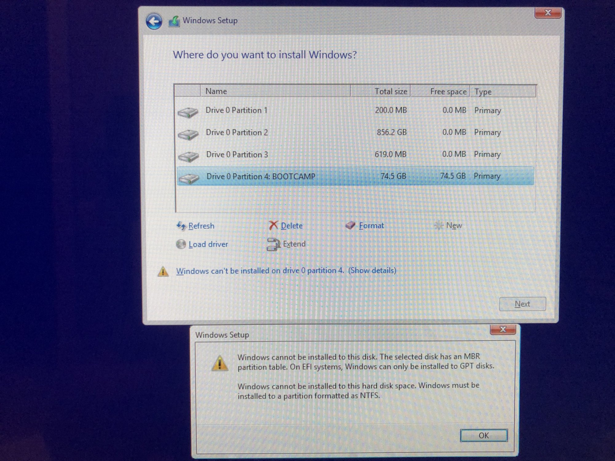

Unfortunately though, I get to the point where I'm starting to install Windows and then get an error about the file format - to which it just ends and it doesn't install.
Changed info.plist:
Enabled settings to USB (I removed Win10 capability):

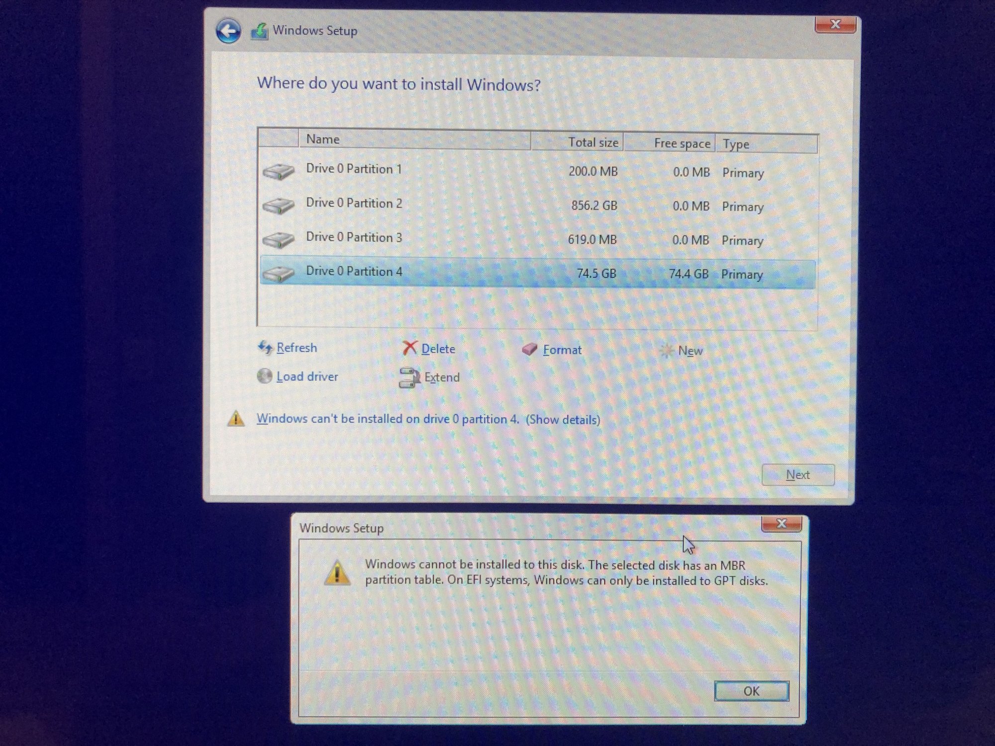

Into Windows installation and error:
Disk Utility shows the BOOTCAMP partition as NTFS (don't have an image of that).
If I Format the BOOTCAMP directory, the drive comes up like this:

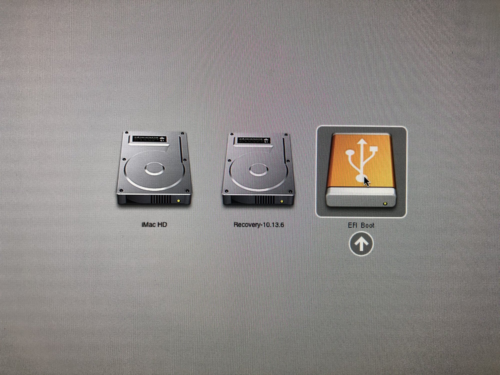

I'm able to quit everything and reboot the computer (after either the 2 previous images) and hold the <OPTION> key to get:
If the USB with the Windows installer is run, I get the 2 errors during install - if I do the others, High Sierra or Apple Recovery run no problems - to which now there's an empty BOOTCAMP disk.

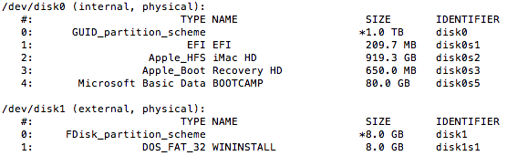

I also have a screenshot of the drives prior to install too:
