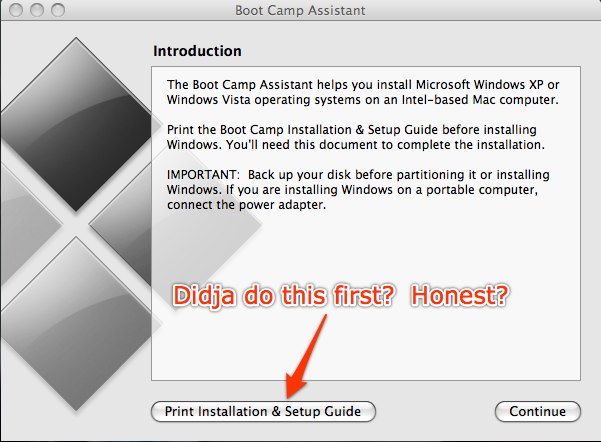

You MUST format the desired partition using the Windows installer; the Mac Disc Utility will not suffice.

I did use BCA to partition is (as FAT32). In the Windows installer I formatted it to NTFS but I get the same"Windows is unable to find a system volume that meets its criteria for install". Some have said once you do that reboot to the installer again and it will recognize it - doesn't on my machine!!!

PS Yes I did print and read the manual and followed it to the letter.
