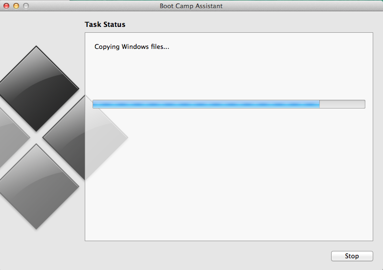

sigh... I downloaded the ISO. file and I get "your bootable usb drive could not be created"
I have searched this problem and I see people unmount it and make sure it's directed to the right iso file so I do this and still get this.
So this is where I am at right now, Normally before the bar wouldn't even get past half way before it would say"your bootable usb drive could not be created" ... So I guess I'm getting somewhere.
The problem is the bar hasn't moved for at least 5 minutes now, I'm not sure how long it takes or should take.. Does anyone have any in sight to this?

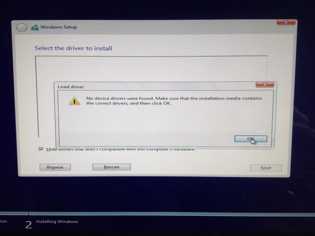

Ok we kinda have some success, but now I'm stuck again!
I get to the set up of windows 8 and select language and all that, then it says select drivers. I assume these are the drivers we downloaded in the boot camp assistant?
Never seen that before.
You didn't select the EFI option when you booted did you? You don't want that one.
You prolly want to ask about this in that other Windows 8 thread.
Or start a new one.
Sorry.
Probably not. Is your USB stick a USB 3.0 type? Try using a USB 2.0 stick.
I'm also wondering whether your original Windows DVD had both 32 bit and 64 bit versions on it. It would object to the 32 bit one.

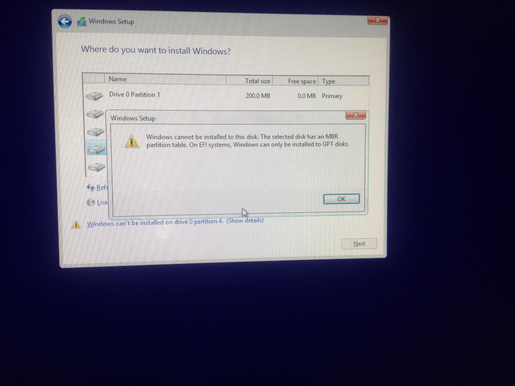

Ok update!
I just tried to start from the begining and put the ISO image onto my external HDD, When I hold down the option key when booting the mac it presents me with my external HDD and says EFI boot (I know you said we don't want that but I clicked it anyway)
and got to the part where you select the disk and the picture below will tell you what happened (probably what you expected)... So is there a way around this? what am I doing wrong? sorry I suck at this. I really appreciate your help though.
ok I managed to install it on there,
what I did was (just so I know for future, cause I will need it you'll see)
I removed Boot Camp on my HDD and then went into disk ultility and then formatted to 1 partition, then I added another partition making it the size I wanted within disk utility and made it as "free space"...
Then I restarted and then booted the EFI disk and began the install, I cannot remember if I formatted it the windows, but that's not a problem.
