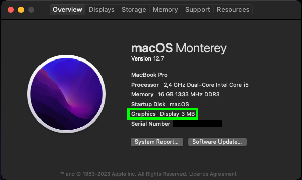

Edit: If the OCLP root patch is not running in your machine, you will know because, apart from the obvious lag, when you check information on your GPU model you will see something like what is shown in this picture instead of the actual GPU model.
