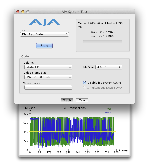

alphaod: those numbers are really nice, but they seem too high, for a set of 4 VR's.
What's the file size used in the tests?
I ask, as it appears that the data is being skewed by the cache (which is nice, so the numbers are accurate for small files). But if you want to know what it does on a file larger than the cache can contain, you can do a couple of things.
Mmmm… old thread, but seeing it's be resurrected, I figured I'd run some test on my RAID5:
