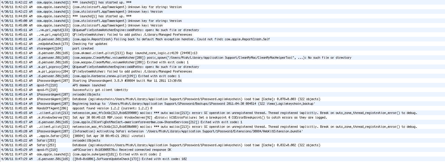

Since I have no idea what I am looking for I am posting a screen shot here.

Try a Safe Boot and see if that works reliably a couple times. Safe Boot is a start with no start up items running. That would rule out Mac Cleaner and iPassword for example that I see you have running.
If safe boot works, remove login or boot load items one by one until you find the cluprit.
